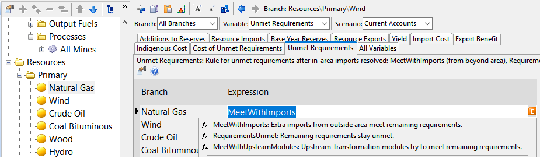

  • Emily Ghosh 3/19/2018
    Hi Felix,
    The option to import fuels or leave fuel demands unmet is now available in the variable called "Unmet Requirements" in the Resources branch. If you click on the "E" at the end of the expression, you will have three options on what to do with unmet fuel requirements, as shown in the attached screenshot.
