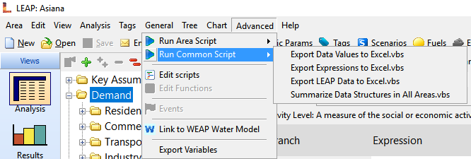

  • Emily Ghosh 4/25/2018
    Hi Nnaemeka,
    Attached is a screenshot showing how to access the common scripts. Another way to do this is through the "Advanced: Edit Script" menu where you can click on "Open" to view the common scripts.

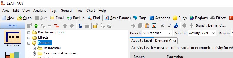

  • Nnaemeka Emodi 4/25/2018
    Dear Emily,
    Thank you for your reply. The advance button is not showing in my version of LEAP as shown below. Is there a way I can make it show up?
    Best Regards
    Nnaemeka.
  • Charlie Heaps 4/25/2018
    First, please make sure you have the latest version of LEAP before testing this script (LEAP v2018.1.8). If you are not seeing the Advanced menu, that is likely because you are using the 64-bit version and a special scripting control has failed to register. If so, either try using the 32-bit version of LEAP, or do a full download and reinstall of the latest 64-bit version.
    Dear Charles,
    Thank you for your message. I actually have the latest version which is v2018.0.18, 64-Bit. Do I reinstall it again?
    Best Regards
    Nnaemeka
    Hi again - do you know If you installed that from scratch (ie a full download) or if you used the "Check for Updates" feature in LEAP to get it? if the latter, that may explain why the script control did not register. But either way, there are two possible ways to fix this:
    1. Use the 32-but version instead, or
    2. Manually register the script control for the 64-bit version. You can do that by
    a) opening a command prompt with admin rights from the Windows Start Menu.
    b) navigating to the 64-bit LEAP program folder. Normally you type cd \program files\LEAP
    c) issue command:
    regsvr32 tsc64.dll
    If this fails, check that you can find the file tsc64.dll in the program files\LEAP folder.
