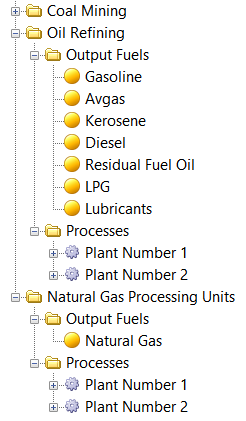

    Typically we group technologies which produce the same output fuels in the same module. This avoids the issue you are having. Within the module, you can include a number of processes to represent different plants. Please see the attached screenshot for an example.
