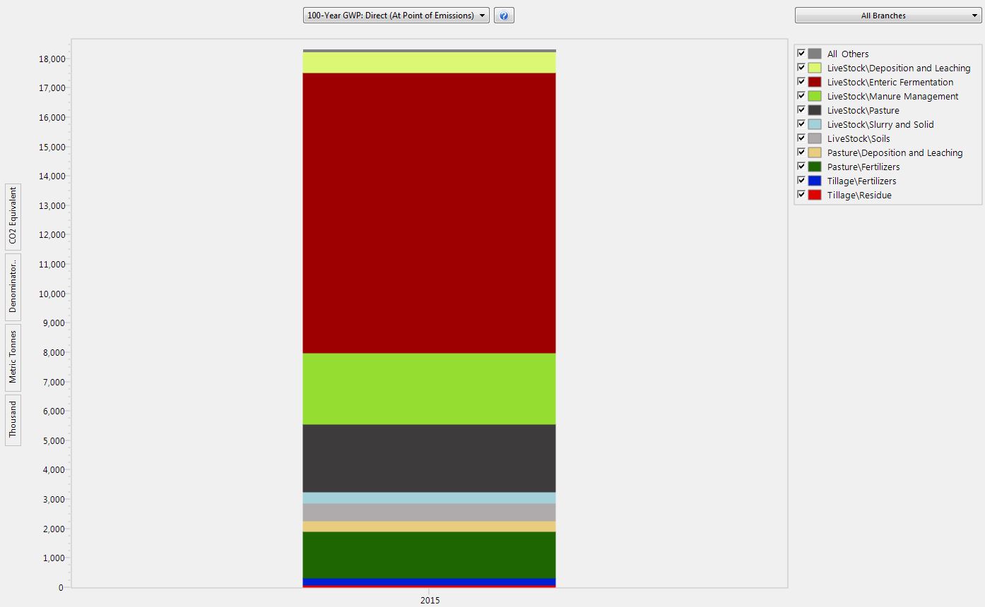

    I thought I would let you know what I did in the end to address this question, I constructed a separate model in excel which accounts for GHG emissions originating from Livestock, Pasture and Tillage, some other details are also included. I used this data to calculate annual GHG loading's for each agri type and animal etc then linked them to my LEAP model within the Non-Energy folder, adding CH4 and N2O emissions here. I am happy that this adequately captures the emissions for which I have data - I have separately created a couple of scripts which then allow me to update figures within the excel sheet and push these to LEAP if I wish to conduct sensitivity analysis of herd size, emissions per head etc.
    The screenshot below shows a sample of the results I am getting for 2015 for one run of herd size
    Best Regards
    Tomas
