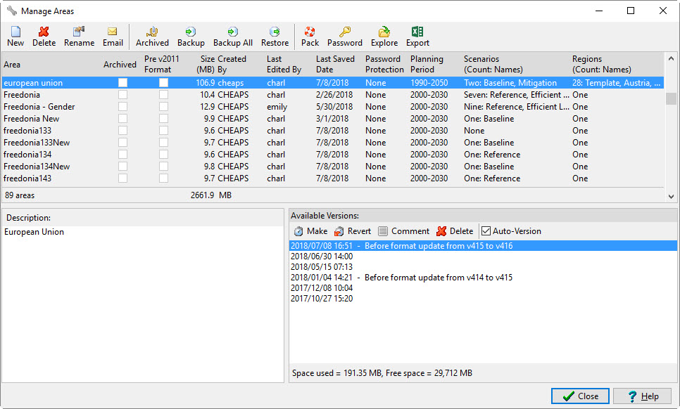

    By the way, you may also want to take a look at the Area: Manage Areas screen which lets you manage the areas installed on your PC. See screenshot...
