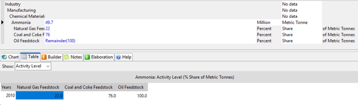

    A bug in the calculation/display of the Remainder function was introduced in one of the 2018 versions of LEAP. Instead of calculating the residual share, it displays 100 instead. This persists even when deleted and readded, and is the same in other similar expressions throughout the branch. The example shown is from .14, but the error was first noticed in .13. Thanks for any help.

    Hi David - could you email me a simple data set that exhibits this issue? I cant seem to reproduce it on my computer. Please also let me know which version of LEAP you are using and whether it is 32-bit or 64-bit.
