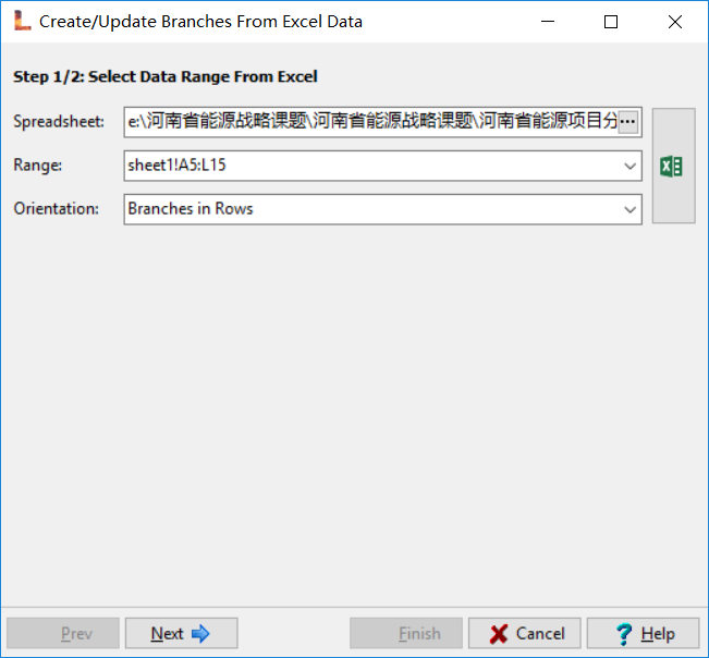

    Hi Emily,
    The same problem has also confused us for a long time. We haven't figured it out how to create/update branches from the excel. We can only use the function "sheet1!A5:L37", and it can only show us the two columns of the data. Could you please tell us how to analyze the all data in an excel at one time? Please give us some advice or suggestions in detail, such as the relevant functions, the detailed methods and the corresponding information. Thank you for your help! Roses, roses all the way!

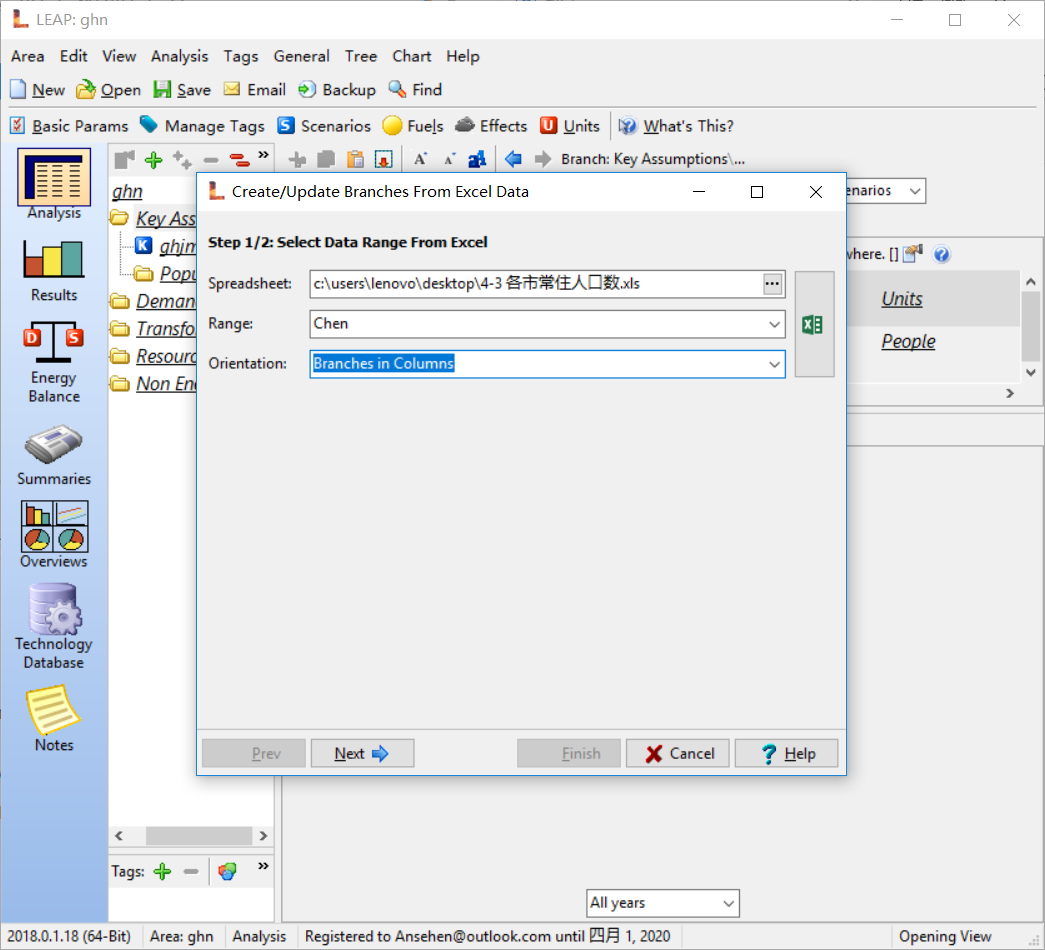

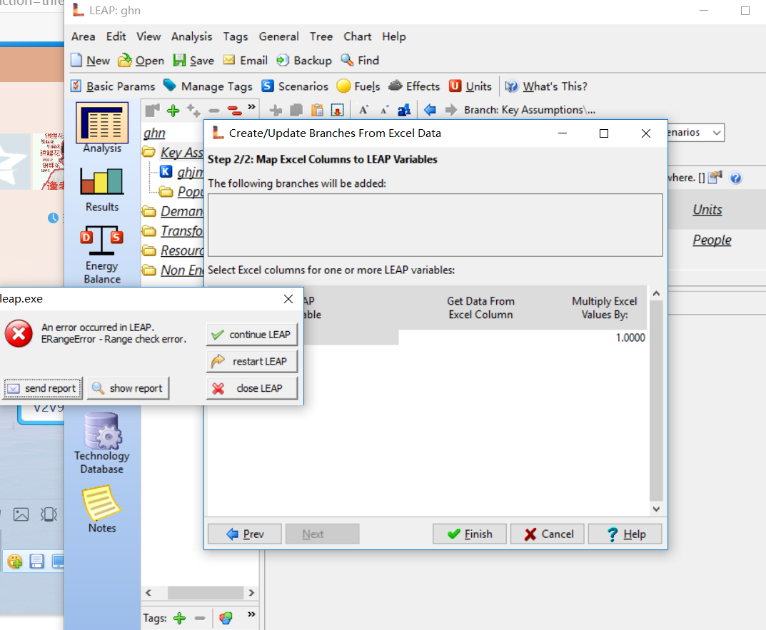

  • Binjie Guo 12/20/2018
    Hi Emily,
    You help and advice have hugely supported our subject. But, still, we are not figure it out. I have done what you have told me, maybe I'm too naive and young, things still get wrong. The name of the data can be found in the Range Option, but it told me there are some errors in it. Really appreciate your help. Danke dir!

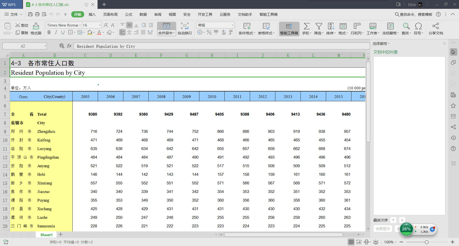

  • Juncheng Chen 1/31/2019
    Dear Talor,
    We have an Excel like this . How can we import it?
    Attachments:  4-3 各市常住人口数.xls [4]
  • Binjie Guo 2/2/2019
    Hi Taylor,
    The excel like this, we can't import all the data in Excel into LEAP, really appreciate your help!
    Yours,
    Binjie
    Attachments:  4-3 各市常住人口数.xls [3]
  • Taylor Binnington 2/12/2019
    Hi, both -
    Sorry for the wait. I'm afraid I can't access your file, and I wonder if it's due to the character encoding in the file name. Could you try renaming it and re-uploading it?
    Based on your screenshot, though, it doesn't look like LEAP would recognize any of that information. Which cells are part of the contiguous range of cells that you are trying to use to create branches? Note that LEAP requires that you name the range before atttempting the import.
