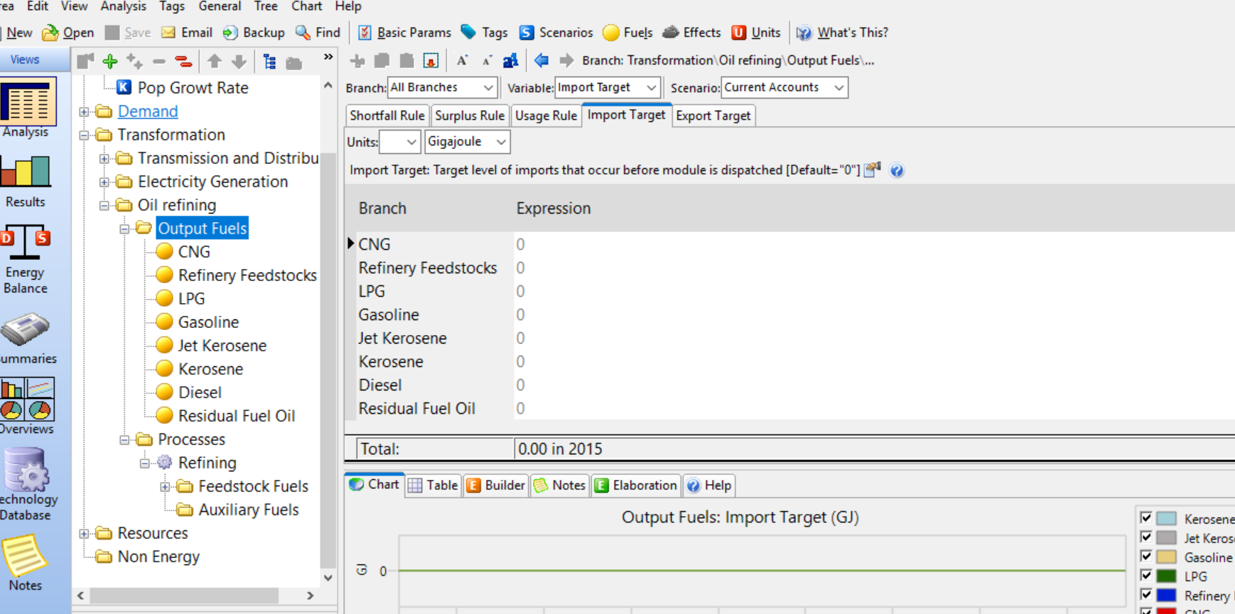

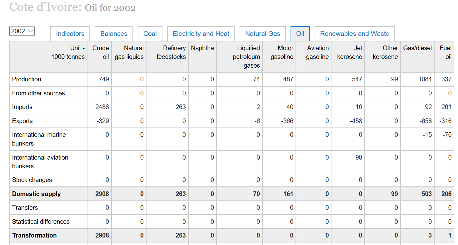

    I have added a refining module to my transformation analysis and was wondering how to input import and export data for output fuels using the data provided by IEA (please refer to pictures attached)

    Hi Yessoh -
    You're looking at the correct variables. You can include imports and exports using the import and Export target variables, and the effect is to increase or decrease the requirements on that module. If you have a time-series of import/export data, you can include them using one of LEAP's time-series expressions (i.e. Interp(), Data(), etc...).
