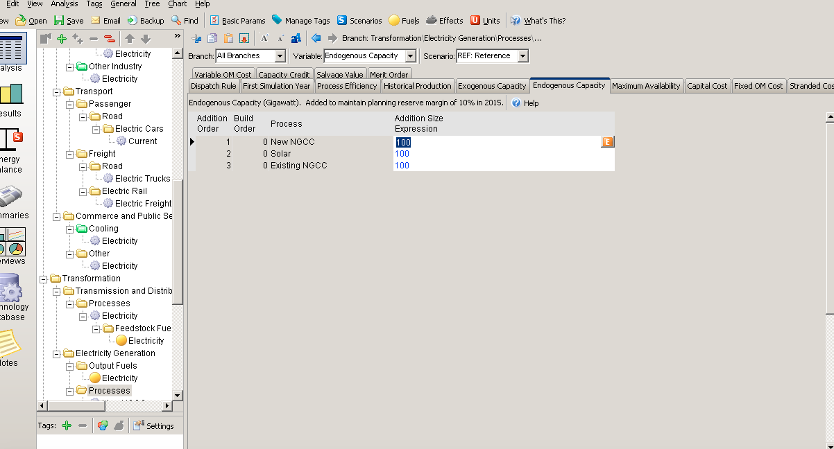

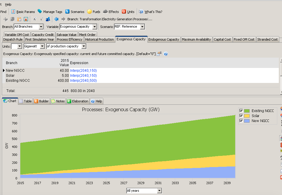

    I keep getting this error "Problem with Endogenous Adding Capacity addition Calculations. This may indicate that demand is growing too fast. Alternatively, check there is sufficient capacity."
    I tried increasing the capacity so much, much more than the demand, and I still get it.
    How can I solve it? IN the attached images, you can see that my electric generation is oversized as I was trying to solve this error
  • Taylor Binnington 11/12/2018
    Hi Hady -
    This error is very often (not always) caused by electricity demand that is growing too quickly/too large in the first place. Try following the recommendation that I described in this post, disabling Transformation & Resources until you're certain that your demand calculations are correct.
