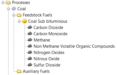

    I would like to ask and clarify why I don't get any results when selecting results/environment/carbon dioxide (non-biogenic).
    As a background, I only have electricity as fuel in my demand branch. I was also able to add environmental loadings only for coal and biomass processes under the electricity generation branch.

    I think the reason why you aren't seeing any emissions results is because the effects branches need to be moved under the Feedstock Fuel branch as shown in the attached image (currently they are under the process branch).
