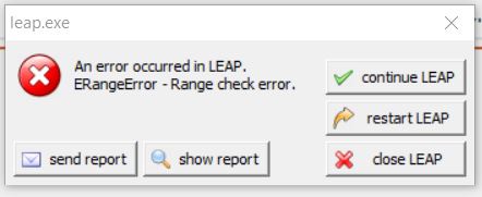

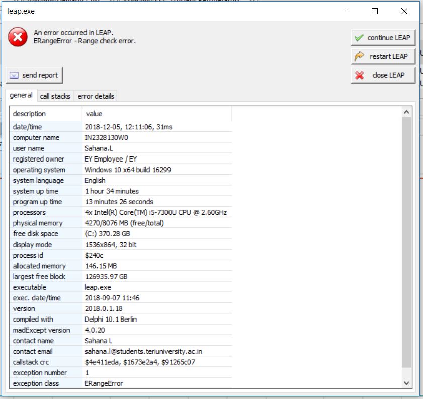

    I was working on Cost-Benefit Analysis exercise from the training documents. After I finished entering the data for the Efficient Refrigerators scenario, I got the ERangeError. Even if I select the option to Continue LEAP, this error keeps recurring. Please help me with this issue.
    I have attached herewith the Error message and the full report.

    Hi Sahana,
    The reason for the Range Check Error is difficult to ascertain from an error message report. Since you are just working on the tutorial, I suggest restarting LEAP and checking the inputs thoroughly before clicking on Results View. If you restart LEAP, LEAP should be able to recover what you were working on before the error occurred. Alternatively, you can open up the Freedonia area built into LEAP (Area: Open) and go back to an earlier part of the exercise (through Area: Revert to Version) and re-enter the inputs for the Cost-Benefit Analysis.
    If you continue to get an error, please let us know.
