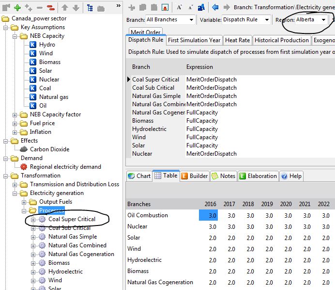

    I am trying to link LEAP-WEAP. In LEAP,  I have 10 regions (provinces) in LEAP.  I need one of the results from the LEAP from region 'A' to be linked with the WEAP input. But when I am trying to do that, LEAP is taking value from the 'template', not from that specific region. How can I link these two tabs? Screenshot attached.
    Basically, I need a value from a LEAP region to my WEAP model (not the LEAP template value).

    Hi Ankit,
    Thanks for your question. Unfortunately, the LEAP-WEAP link currently only works in a single-region model.
