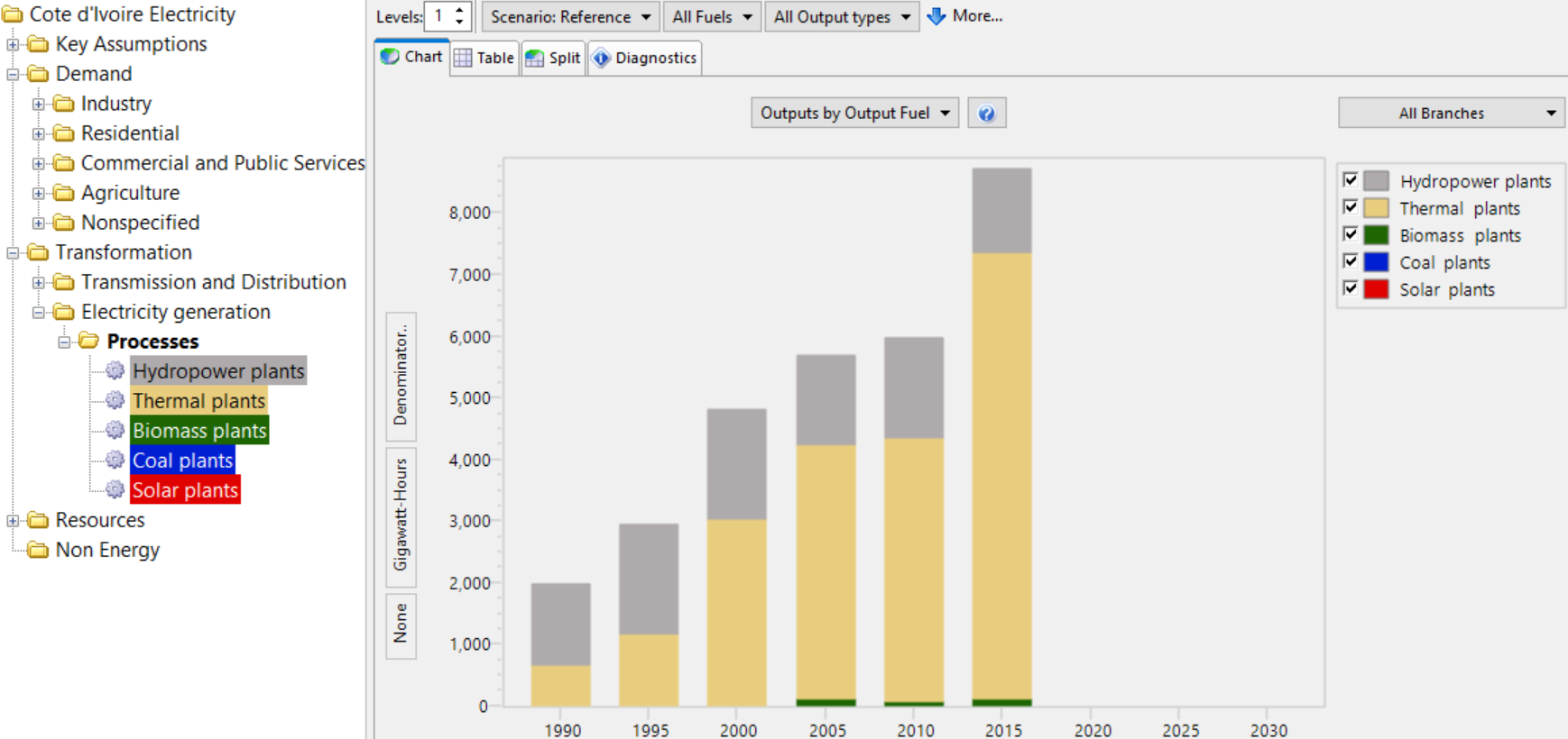

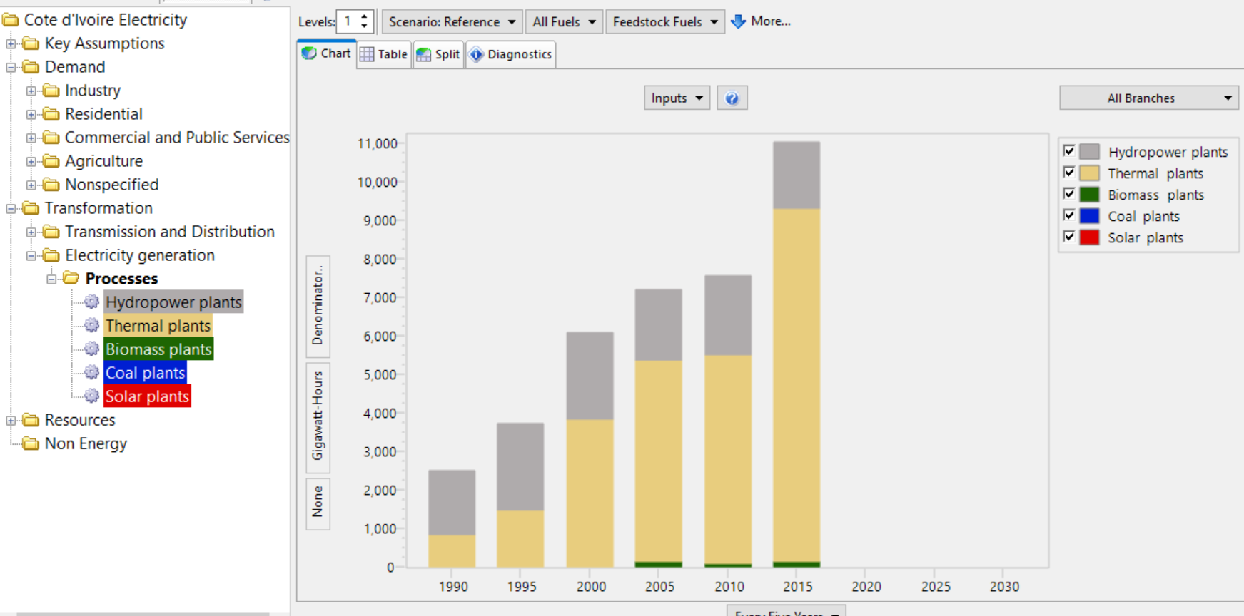

    I am modelling the electricity sector of my country. I have got a demand and transformation module. Unfortunately, for my reference scenario, the results for the transformation module (outputs by output fuels, output by feedstock fuels, inputs do not show the years after the base year which is 2015. The study goes till 2030.

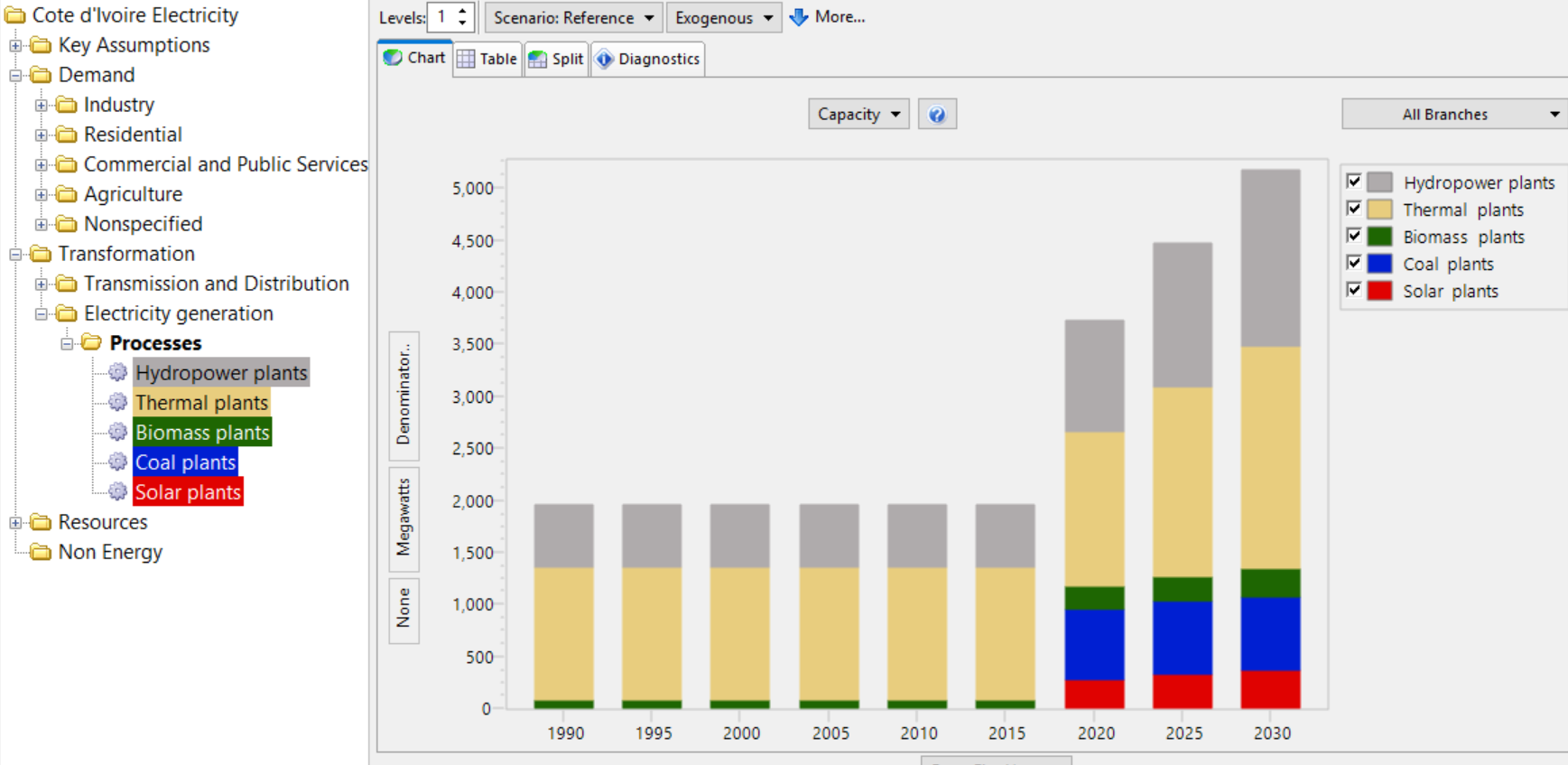

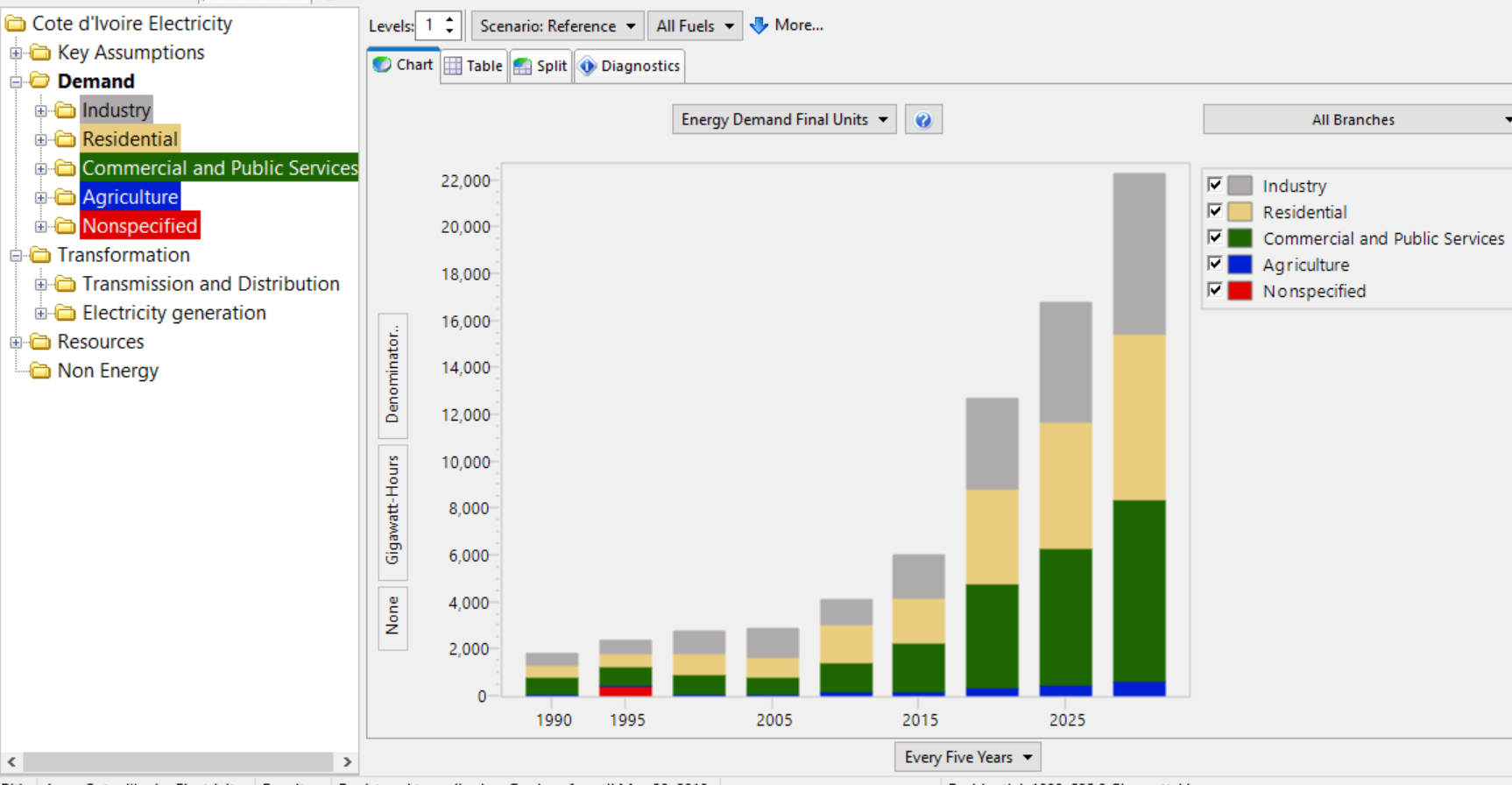

    Surprisingly, the results for the demand module (Energy demand final Units) and for transformation (capacity) are fine. I need to understand where the problem is. Thank you for your time

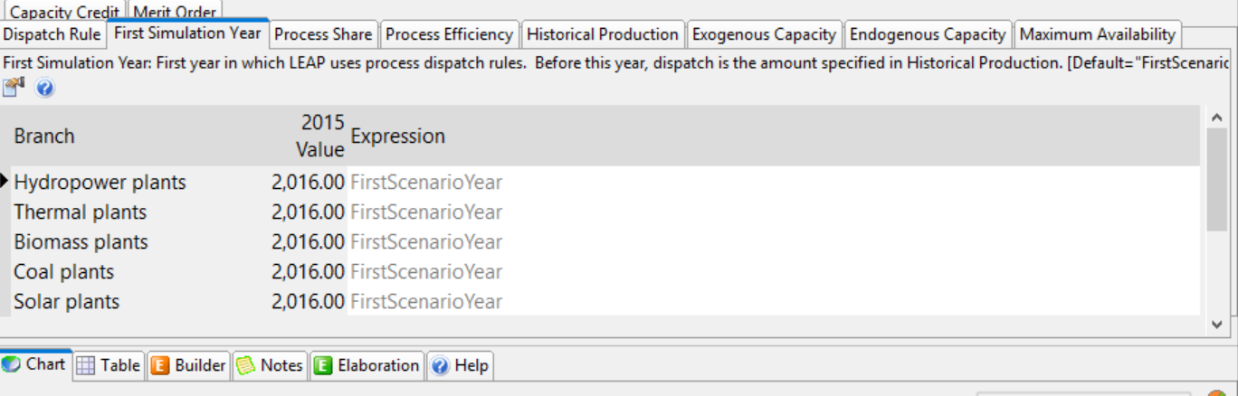

    Thank you for providing the screenshots; it is very helpful. It appears that there is capacity available in all years, but the plants are not being dispatched beyond the base year, and therefore not generating any electricity. My guess is that some of the variables needed for the calculations have not been specified which is why you are getting this result.

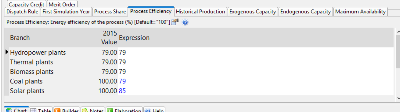

    Please go back into Analysis View and check that the Process Share, Process Efficiency, and Maximum Availability variables all have values greater than zero. If they are 0, they will not generate energy. The reason why you have generation before the base year (or before the First Simulation Year), is because generation in these years are based on the values you inputted in the Historical Production tab.

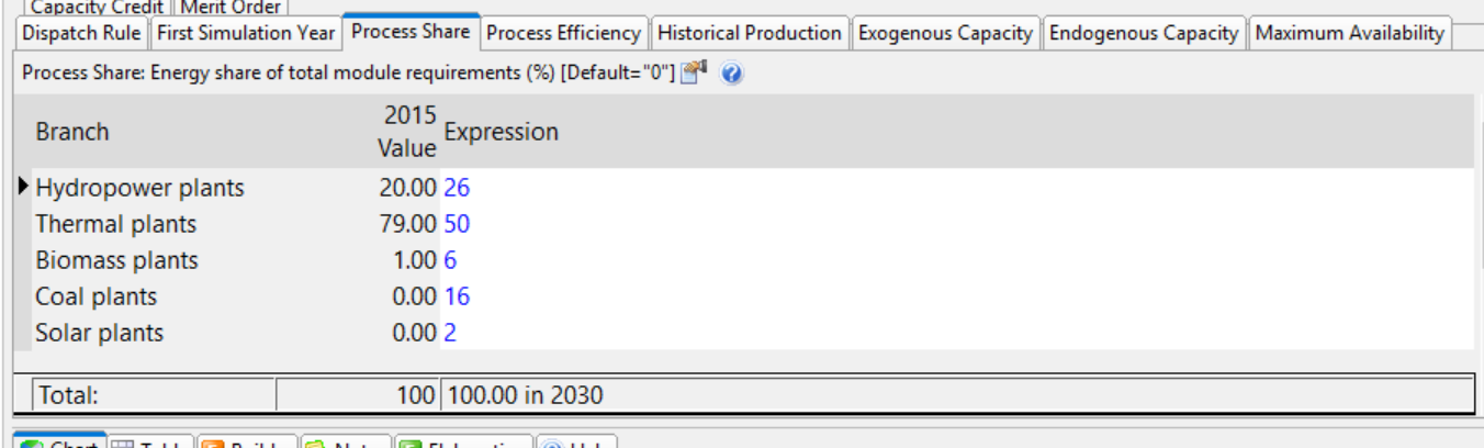

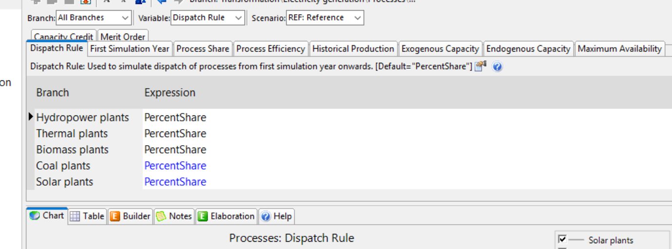

    In particular, if your Dispatch Rule is set to PercentShare then check the Process Share variable. I'm guessing the values are zeros in your scenarios.

    Thank you so much for your quick responses. Unfortunately it does seem that the problem comes from somewhere else. None of my variables for the items you talked about are zero as u can see from the screenshots. I did before a similar model but a larger scale (national scale) and the electricity generation module looks the same as what i built for the current work except that for my previous work, i listed all the power plants at the "current account".
    Here, for the current account, only 3 power plants are modelled. Two others are added up in the reference scenario. So, i still cannot figure out, what did i do wrong. Thanks to have a look again. I appreciate the time you take in this platform. Your work is awesome.
