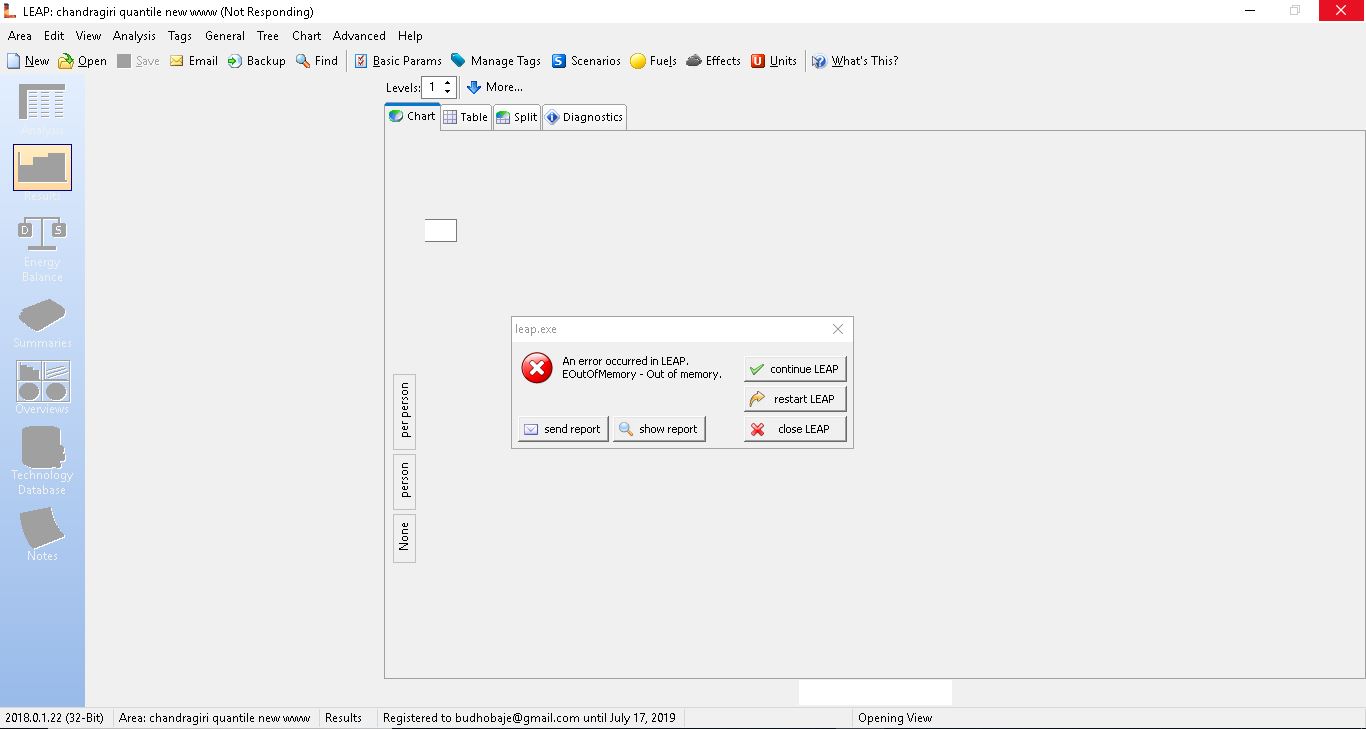

    An error occurred while trying to see result but every thing is OK in analysis and energy balance.i have attached screenshot of the error

    Hello Rojeeb.
    How many scenarios are You running? It looks from your screenshot that You don't have regions in Your model, so I expect You would run many scenarios.
    I had this problem often in the past and it was due to 1 thing: Big model.
    You are using 32-bit LEAP, which (like all 32-bit programs) have a limitation on RAM use of 2GB. If You are running a big model, this may be enough, and generally make LEAP start acting strange.
    I would encourage You to:
    • Check if Your computer is running 64-bit Windows (guide here: https://support.microsoft.com/en-us/help/827218/how-to-determine-whether-a-computer-is-running-a-32-bit-version-or-64)
    • If so, download the 64-bit version of LEAP (same license, same features) (link here: https://www.energycommunity.org/default.asp?action=download)
    • Try Your model again.
    Does this help?
