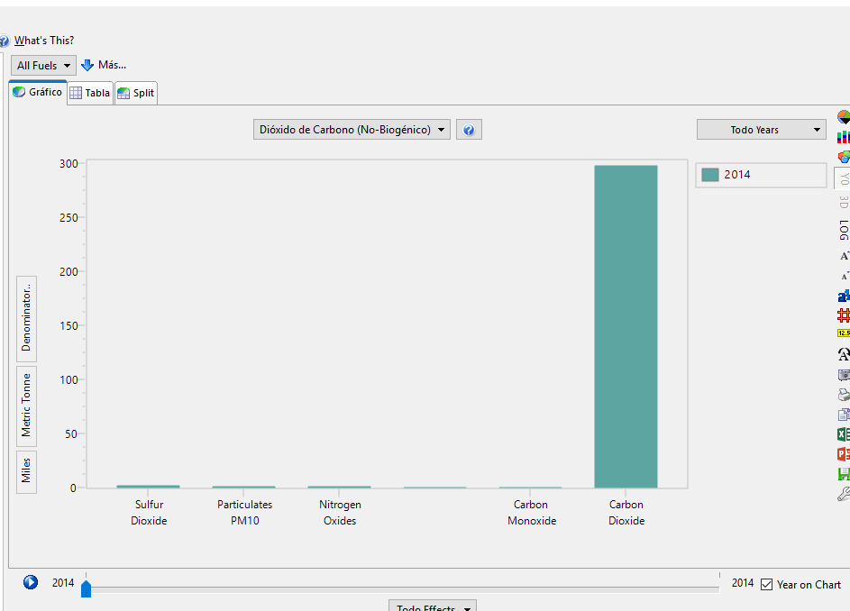

    Good afternoon.
    I have a problem and that is that the results only show the base year and not the projected year. I would like to know in which part I should introduce the HistoricalGrowth function and enter the historical growth data.
    I hope you can help me
    Thank you

    Hi Karen,
    In the screenshot you sent, it appears that you are only looking at the Results for 2014. If you were to view the results for all years (select "All Years" or "Todo Años" at the bottom of the screen), do you see results for other years?
    To forecast future energy demands, you will need to into Analysis View, switch from Current Accounts to the scenario you are interested in and write the HistoricalGrowth function in the Activity Level variable of the high-level demand branches. I recommend reviewing Training Exercise 1 which demonstrates how to do this for the Growth function (just change Growth to HistoricalGrowth in your case). The training manual can be found here: https://www.energycommunity.org/default.asp?action=trainingmaterials
