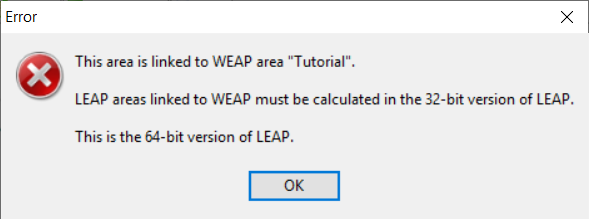

    I was trying to to link LEAP to WEAP by performing the exercise given by SEI and this error appeared.
    I have already developed both LEAP and WEAP models for hydro power stations in an energy system and I am concerned that the LEAP model will not work if I install a 32-bit version of LEAP. Is the only way to link LEAP and WEAP by having both softwares in the 32-bit version?
    I thank you in advance for your help.
  • Taylor Binnington 3/13/2019
    Hi Fabio - that's right, you'll need to the 32-bit version of LEAP.
    This is something we hope to address in the future, but we can't offer a timeline on it right now.
