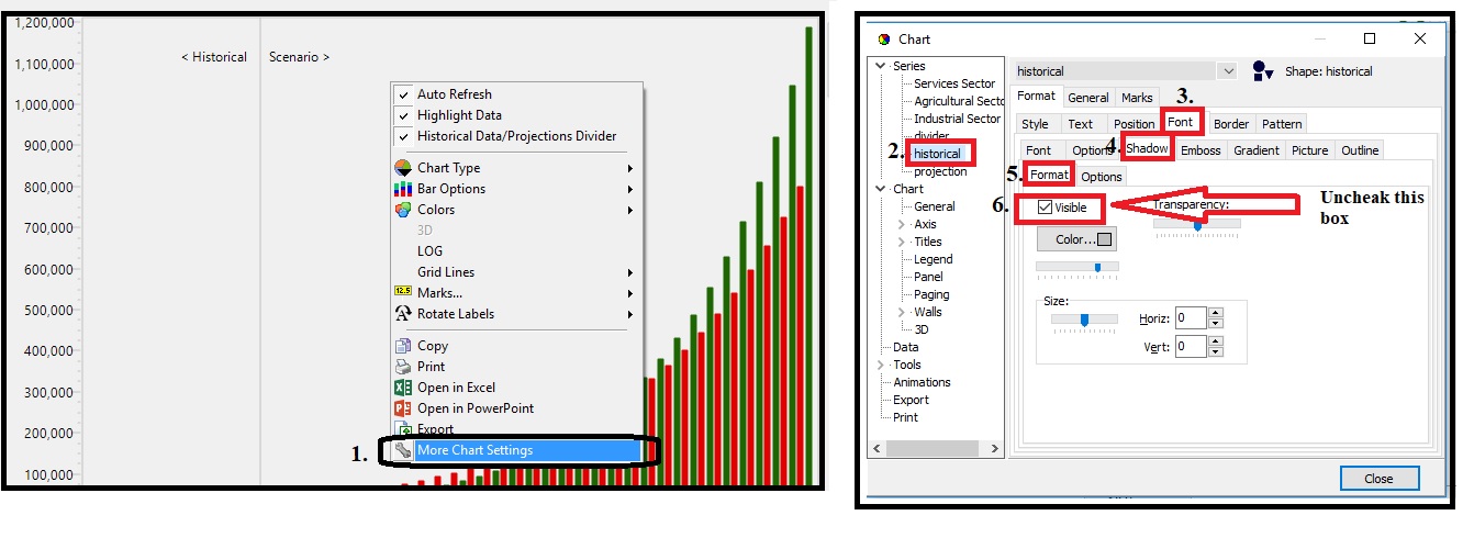

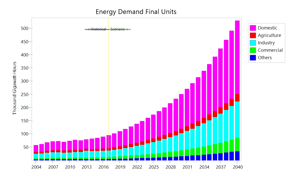

Dear team,How to remove the line named historical scenario from the graph shown in figure below?

Hello Dear, Below in attachment i design a picture tutorial for you and follow these steps to resolve your issue.
Note: Follow these steps in results mode.
