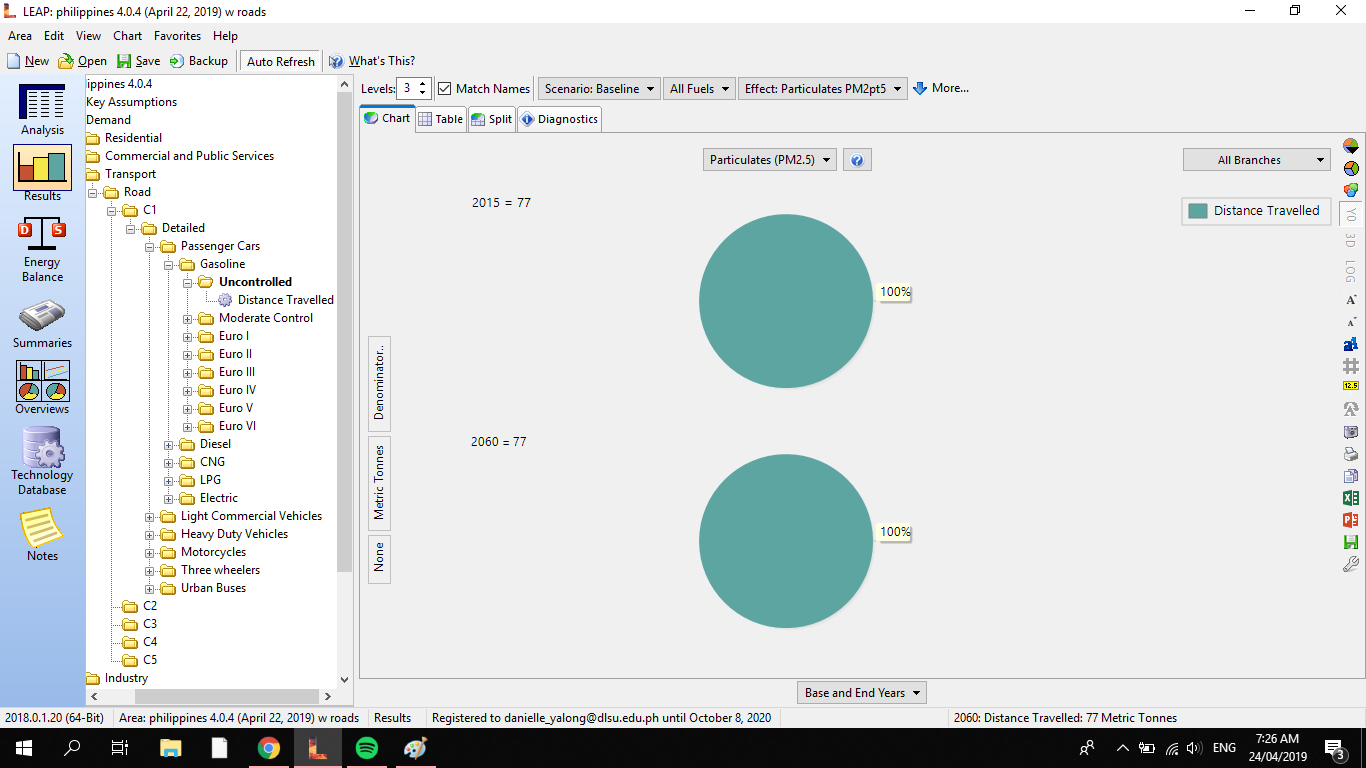

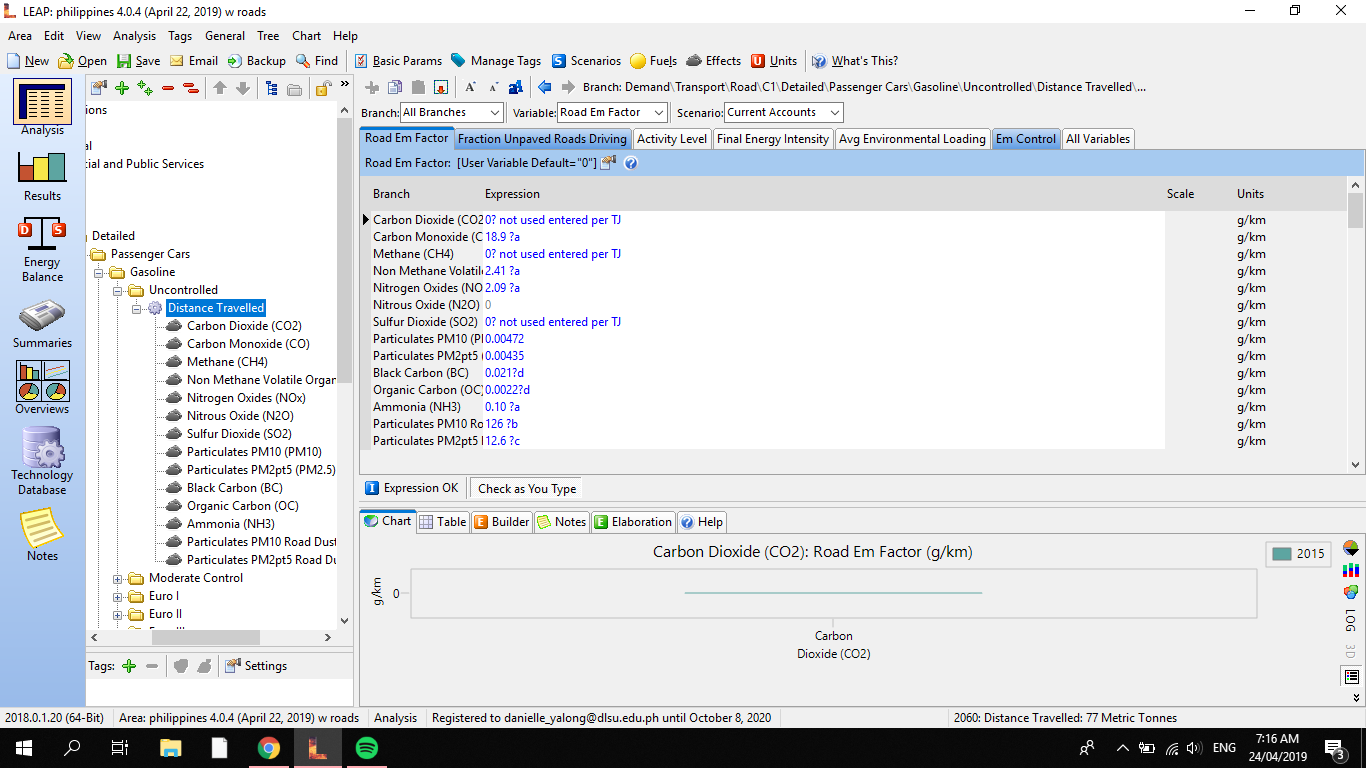

    Hi.
    I tried to run my leap file results and it was able to show numbers. However, I wasn't sure how to show data on Road EM Factors under Distance Travelled in my results because the only thing that's running in that branch is the Distance Travelled. Is it possible to run the results on Road EM Factor as well?

    Hi Bianca -
    Try selecting Effects -> All Effects (instead of All Branches), from the menu on the right of th chart.
    Let us know if this is the type of result you were trying to generate,
