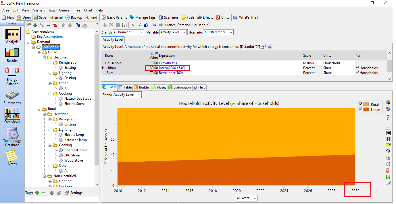

    I am a new user so I am learning to use the software through LEAP Training exercises.
    The problem that I have encountered is when I entered the "Interp" function of 2040, the X-axis on the lower right screen doesn't show 2040 as I wanted. Instead the maximum number of years shown on the X-axis is only 2030.
    Could anyone provide a solution to this matter? Or maybe I am wrong at anything, please kindly recommend me anything.
    Best regards,
    Degeorge
  • Emily Ghosh 8/23/2019
    Hi Degeorge,
    Be sure to change set the End Year in Basic Params to 2040, as per the instructions on page 10 of the training exercises.
  • Degeorge Dul 8/23/2019
    Hi Emily,
    Thank you so much for your help, you're a life saver.
