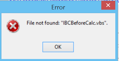

    Did anyone had a problem with the IBCbeforeCalc.vbs.
    For every result I try to get from LEAP I get the message "File note found: "IBCbeforeCalc.vbs""
    After all the data go off.
    See atttachment
    Thanks

    Sorry for the delayed response. If you are using the 64-bit version of LEAP, it is possible that a DLL file used to run scripts wasn't properly registered. One alternative is to download and use the 32-bit version of LEAP. Otherwise you can fix the issue by following the steps below:
    1. Download the DLL file from this link: ftp://ftp.energycommunity.org/leap/tsc64.zip
    2. Unzip this file, and save the the DLL file to your LEAP program folder (normally C:\Program Files\LEAP).
    3. Register the file by following the steps on the last post of this thread: https://www.energycommunity.org/default.asp?action=9&tid=3984&fid=22&MsgID=10977
    Hopefully this fixes the problem, but if you continue to get an error, please let us know.

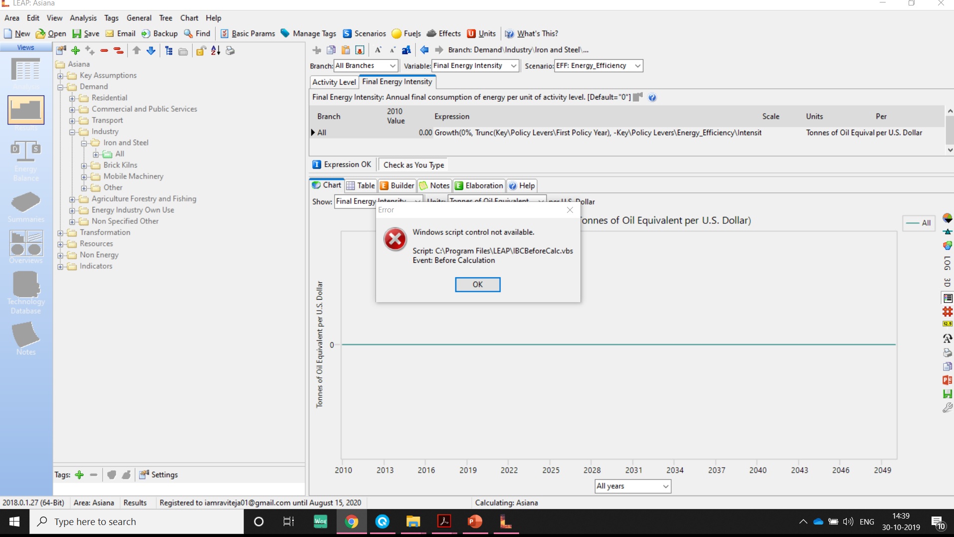

  • Raviteja Kusuma 10/30/2019
    Hi Emily,
    I am unable to download the file from FTP link. Can you please post a working link?
    Ravi

  • Raviteja Kusuma 11/6/2019
    Hi Emily,
    My apologies, I couldn't download using my university network due to firewall. I've downloaded and registered the file, no issues now.
    Thanks a lot.
