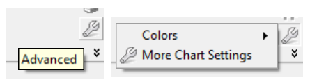

    I was using the "Asiana" in LEAP and I tried calculating (See figure below) then the aforementioned error message showed up. Calculating the "Asiana" shows an error message similar to the message popping up whenever I'm trying to do my calculations in my LEAP file. I am supposed to calculate transport emissions.
    I apologize for asking this: where can I find the Advanced: Events menu? I only saw Advanced option (see attached .png file).
    I am using Windows 64-bit and the 64-bit LEAP software.
    Thank you for your response. I apologize for the inconvenience.

    I uninstalled the 64-bit LEAP software, then installed the 32-bit software instead. I am still using 64-bit Windows. I found the Advanced: Events menu wherein I cleared all the events. My calculations worked.
