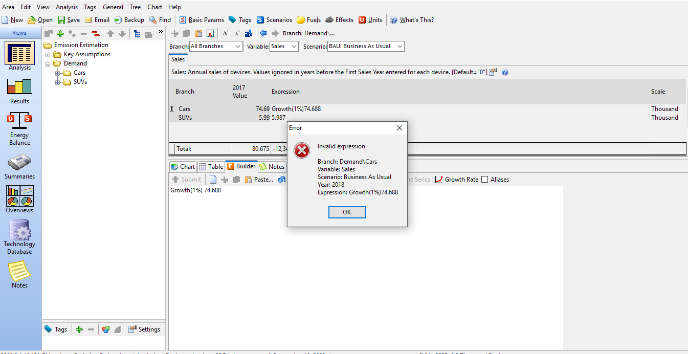

    Hey Emily thanks for the reply.
    Just tell me one more thing that why this error occurs? i mean i want 1% growth rate annually but it shows me this error.
  • Emily Ghosh 9/17/2019
    Hi Siddiqua - The expression says Growth(1%)74.688, but the expression should just be Growth(1%). The growth rate will apply to the values written in Current Accounts, so there is no need to rewrite the value in the expression.
