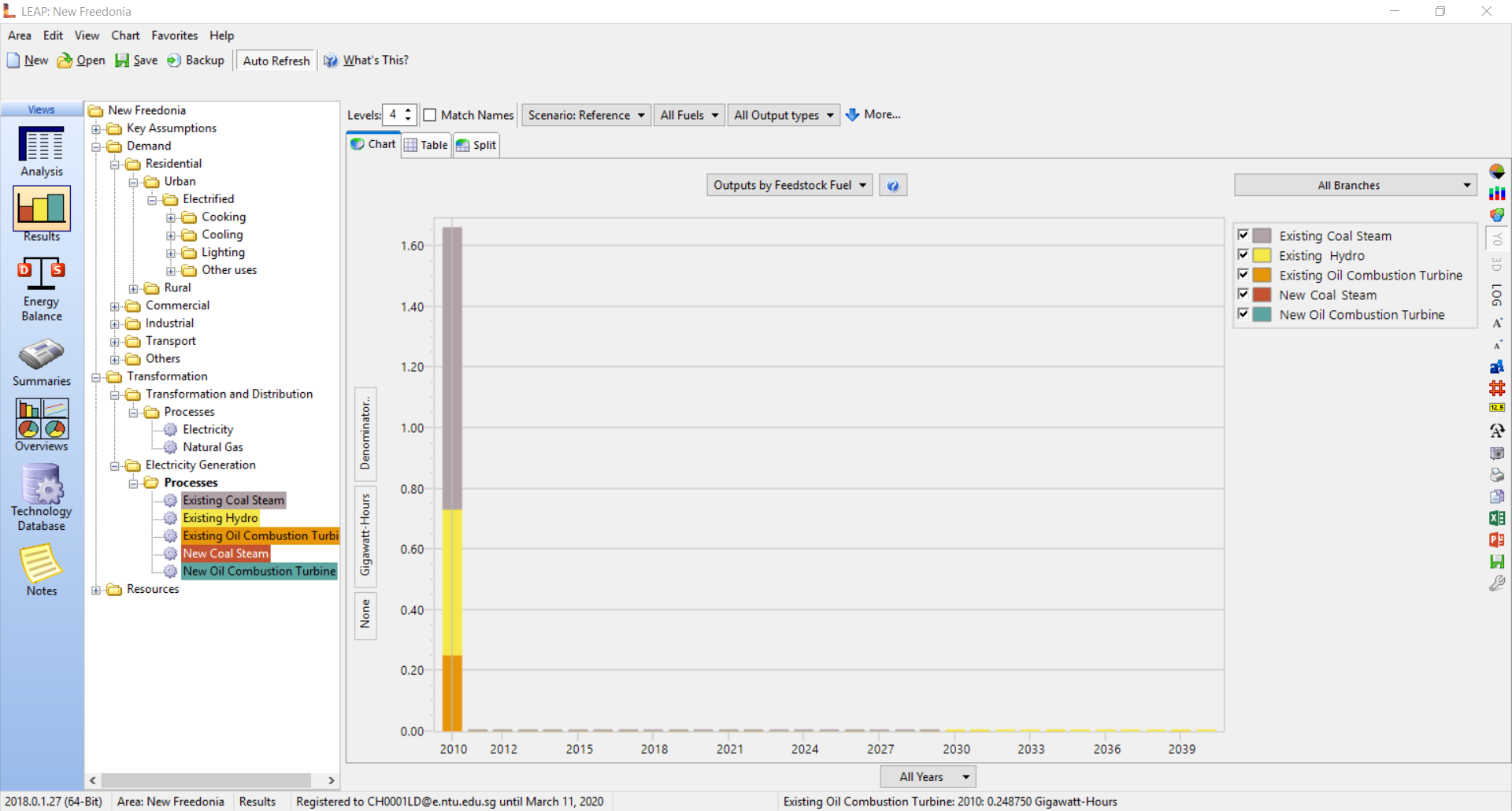

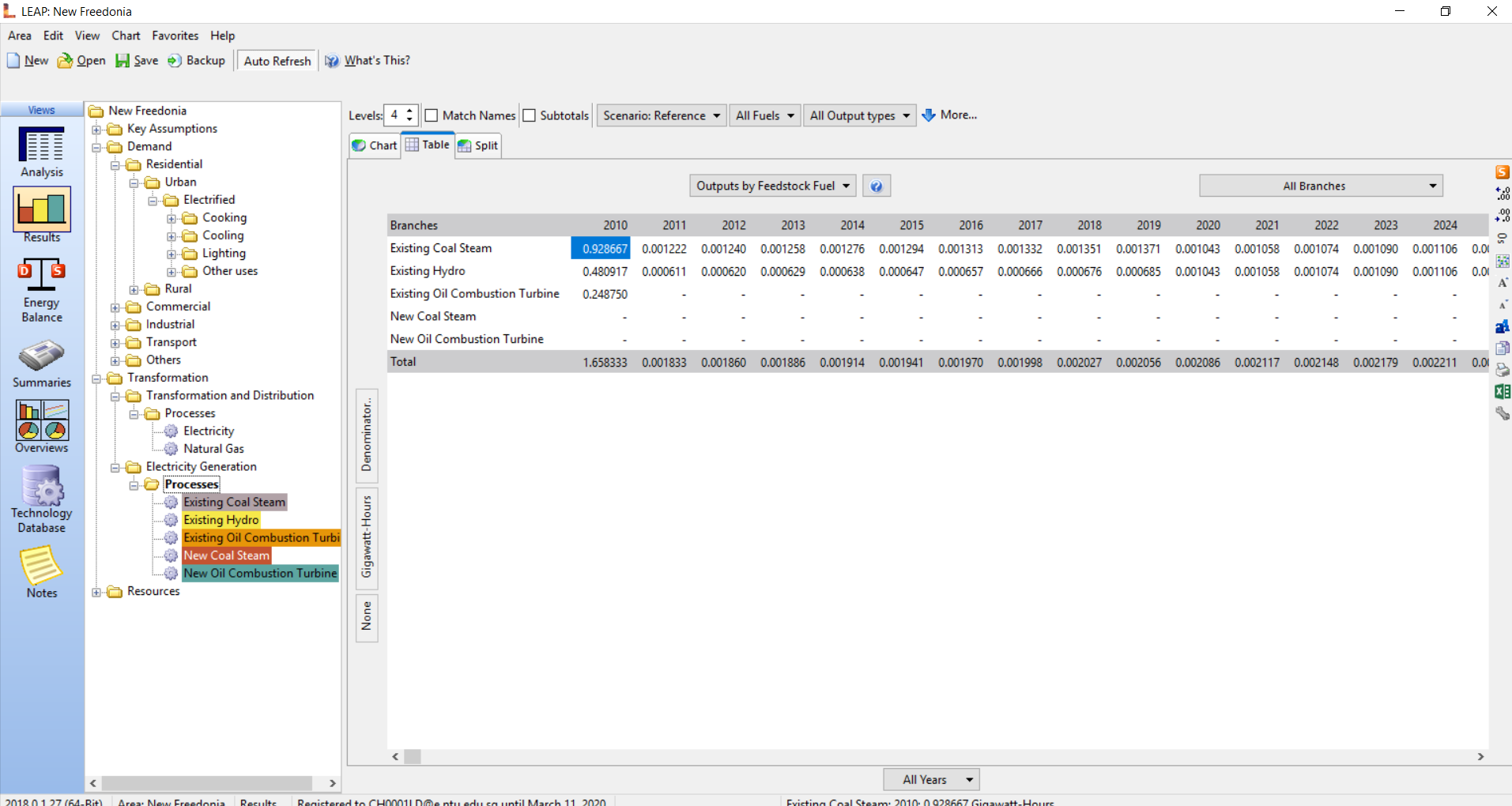

    Hi all,
    I've followed the instructions o the training exercise for Transformation and Distribution, as well as Electricity Generation to simulate supply side of the energy model. However, my electricity generation seems fine for the first year (2010), and then immediately drops to a ridiculously low level from 2011 onwards. Any suggestions on where I have made a mistake in my analysis? All help is appreciated, thanks!

    Please take a look of your demand and transformation branches in your reference scenario
  • Utsavshree Rajbhandari 12/17/2019
    I would also suggest you to look at mainly in demand branch.
    The problem could be - you have had assigned historical production for base year 2010. Thus the output seems fine.
    But in demand side, the actual demand could have been low, and thus in future years, the production would be as much as demand only.
    To cross check the results, look at Module Energy Balance result under Transformation. If the case is as i have mentioned, there would be surplus energy in production side in 2010. But in other hand, if it's not the case,  there could be imports to meet the same demand in later years, it will be also visible in this results.
