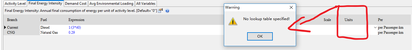

    Hello!
    I recently updated the latest LEAP version (2018.1.28(64-Bit)) , and then the unit of the final energy intensity becomes unselectable. Clicking the unit button will bring up a warning dialog box. This question does not know how to solve it. Also, where can I download the old version? Thank you!
  • Charlie Heaps 10/7/2019
    Apologies - this is a bug.  I'm working on a fix ASAP.  Stay tuned!
    This should be fixed now.  Please download LEAP2018.1.29 here: https://www.energycommunity.org/default.asp?action=download  and let me know if it fixes the problem for you.
  • Linfeng Duan 10/8/2019
    I downloaded the latest version (2018.1.19(64-Bit)).This problem has been solved. Thank you very much!
