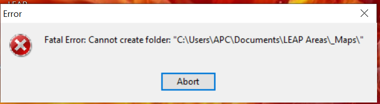

    After setup LEAP, I run leap but have an error like attched photo, I don't known why
    Could you help me solve this problem?

    I think this message is due to you having insufficient access rights on your PC. Please create that folder ("_Maps" under "LEAP Areas)
    manually and then try running LEAP again. Ideally, its best if you can run LEAP with admin rights at least once after installation.
    I will have the folder created automatically by the Installation routine in a future release to try and avoid this issue.
