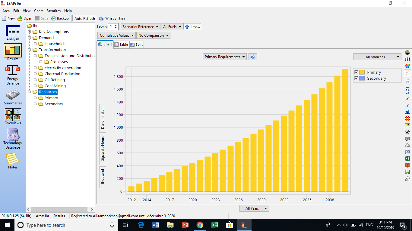

    firstly i am comparing my exercise model to freedonia model. all inputs are kept same except demand tree where industrial;, commercial and transport sectors are not being used. will they affect the graph results of transformation tree, electricity generation process and resources graph.
    secondly see the attached graph the secondary resources graph is having very low values what can be the issue. is the wrong graph being generated due to non use of all demand sectors as mentioned earlier. please guide.

    Hi Ali,
    LEAP's supply side and resource calculations are demand driven, so you will need to enter all of the demands in order for LEAP to correctly model the amount of supply and resource requirements that are needed to meet the demands.
  • Ali Tamoor 10/22/2019
    thanks alot. i understood the point.
