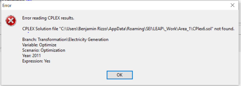

    When trying to run the optimisation example using cplex I get the following error
    Thanks for your help.
