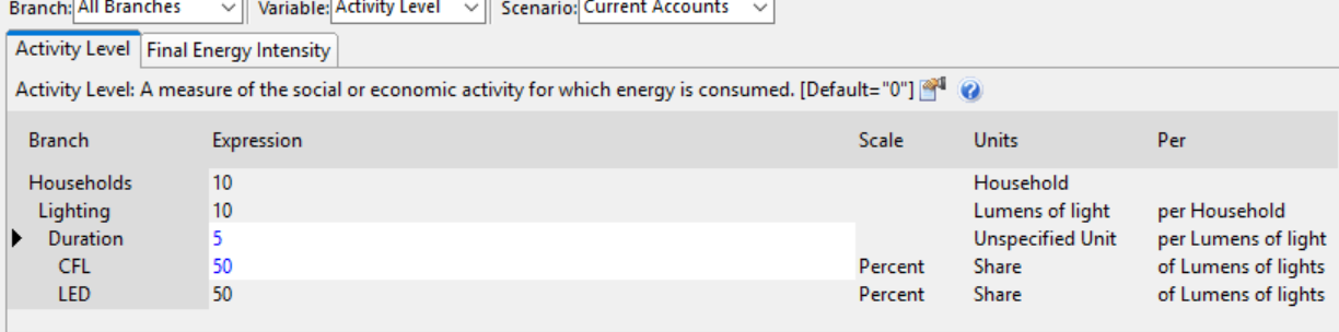

  • Anjana Das 4/1/2020
    Dear Charlie
    Thank you once again for your help.
    I could manage to get the calculation done correctly for small case, by
    defining number of households, lumens of light per households, duration per
    households at different levels as activity and then defining technology with
    share and energy intensity at the lowest level. But, I wanted to define duration
    per households in hour (LEAP defined as per Lumens of light based on unit of previous activity level (Please see the picture)), however, could not use a non-energy unit, so I defined
    as unspecified. I enclosed the picture, it would be nice if I could use hour,
    it would look correctly.
    Please let know if you have better advice.
    I tried to
    use the User Variables, but was not successful. I searched the document LEAPTrainingExerciseEnglish2015
    for some description, but it is not there. It may be a useful feature, so I would be interested to know how to use it. Would be grateful if you could kindly share some
    presentation/materials that explain the User Variables.
    Thanking you in advance
    Best regards
    Anjana
  • Emily Ghosh 4/1/2020
    Hi Anjana,
    If you would like to create/add new units, like "hours", refer to the following help page: https://www.energycommunity.org/Help/Supporting_Screens/Units.htm
    To learn how to create User Variables, refer to this webpage: https://www.energycommunity.org/Help/Supporting_Screens/User_Variables.htm
    If you have any other questions, please let us know.
    Hi Emily
    Unit worked, now it looks good. I will look into the Users Variable materials.
    Thanks you
