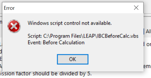

    When we ask LEAP to solve Asiana model for results, I get this error (please see the attachment), my colleague also gets the same error message. Please let me know how to fix it.

    This most likely means you are using the 64-bit version of LEAP.  Can you confirm by reply that this is your case? Please also let me know exactly which version of LEAP you are using.  The 64-bit version sometimes has problems running scripts due to a certain component (tsc64.dll) failing to register properly with Windows.  There are two things you can try:
    1.  Run the RegisterLEAP.BAT file in the LEAP program folder.  Open a command window with Admin rights to do this.  You MUST have administrative rights for this to work correctly.
    2.  A more reliable solution is to use the 32-bit version of LEAP.  This tends to work better with scripting and also is somewhat faster than the 64-bit version.
    Also check the Help:About screen to see what it says about whether the needed components have been properly regsitered.
    FYI, I am working on making scripting more robust in the 64-bit version.  This will be part of LEAP2020, which is due for release in early May.

    We are using 64-bit version.  We tried with the Step 1 you have suggested and it worked.

    Option 1 is also working in 64 bit. I really appreciate for it as I am also facing the same issue. Now I am happy.
