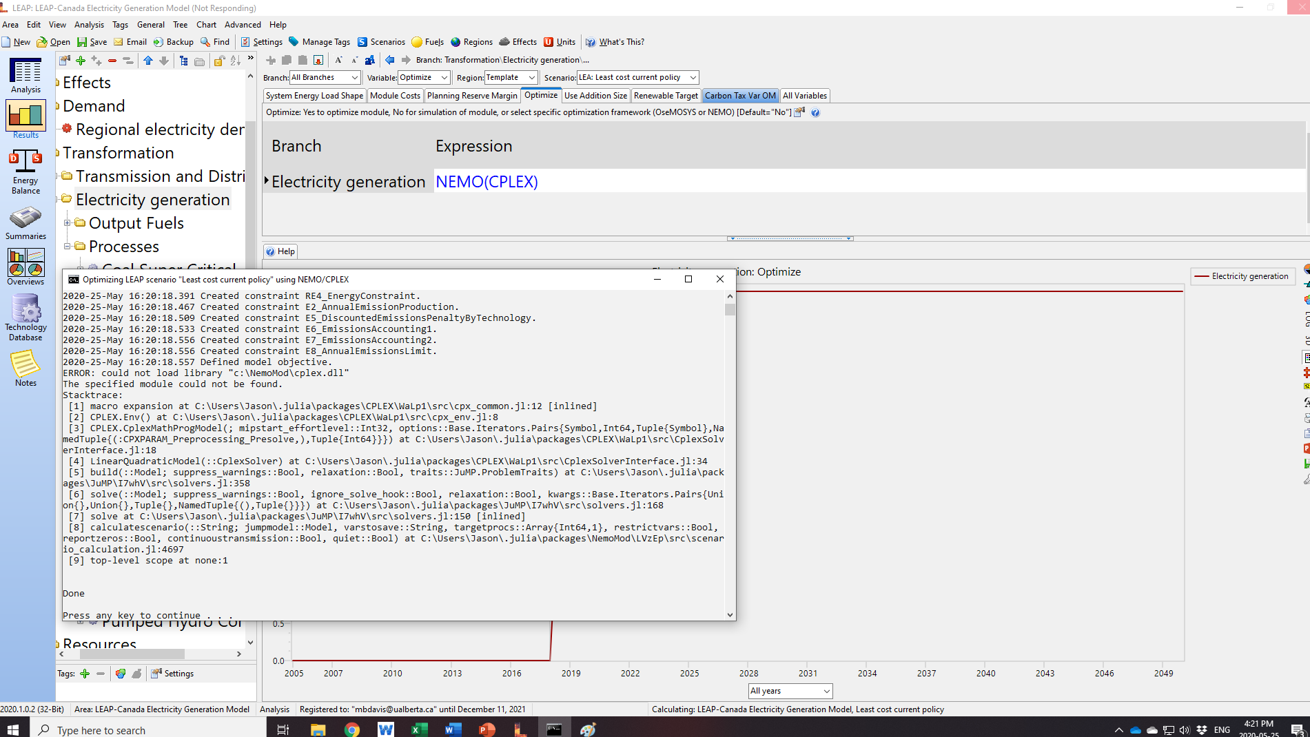

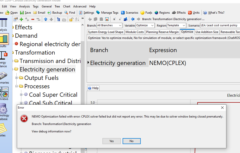

    I am running into an error when optimizing with NEMO(CPLEX). The attached files shows the error. The model does run correctly if I use NEMO(GLPK) or OSeMOSYS(CPLEX). Let me know if you could use additional info.
    Matt

    Hi, Matt. It sounds like this problem might be related to the version of CPLEX you're using. The Julia CPLEX interface shipped with NEMO only supports CPLEX versions 12.8 and 12.9. Apparently IBM changed the CPLEX API substantially with version 12.8, making it impractical for Julia to continue to support older versions. What version of CPLEX do you have? Depending on what it is, I may be able to provide a work-around.

    Hi Jason,
    Thanks for the reply. I am currently using version 12.10. If needed, I can switch to an earlier version.

  • Jason Veysey 6/9/2020
