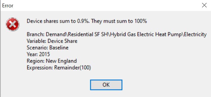

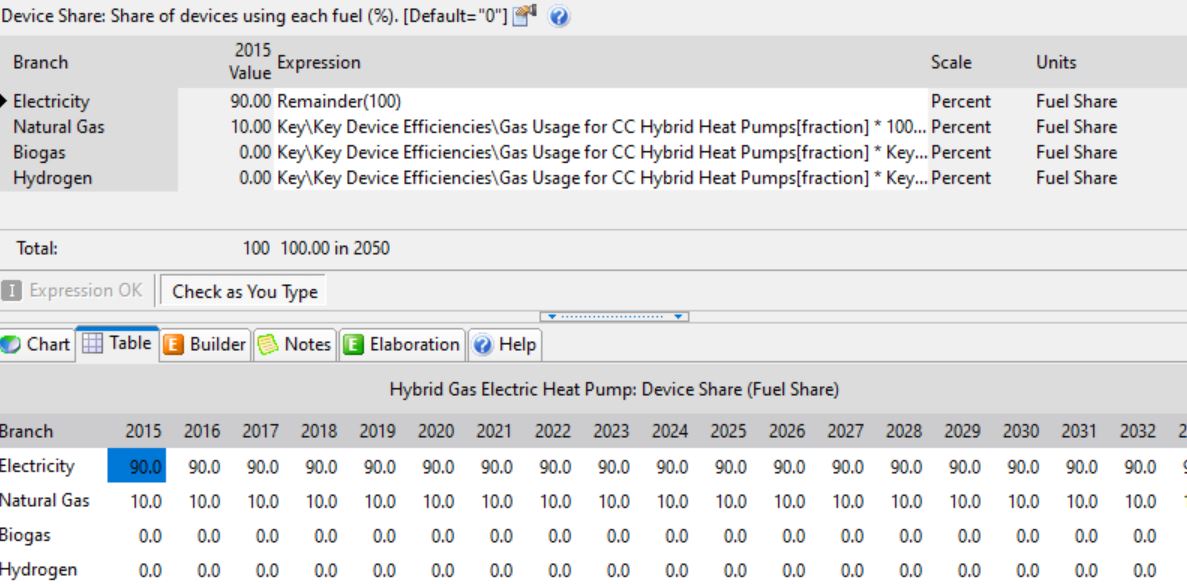

    I am getting a bug in LEAP2020 where analyzing device using stock turnover with non-zero device share seems to break when there are multiple device shares. I've included a JPG of this error, as well as an example of the device share user variable with this arrangement. This model runs okay on LEAP2018 (v1.4), but seems to cause an issue with LEAP2020.

    If you can send me your data set as a .leap file I can take a look at this. Please send to charlie.heaps@sei.org
    Thanks and sorry for the problems.
