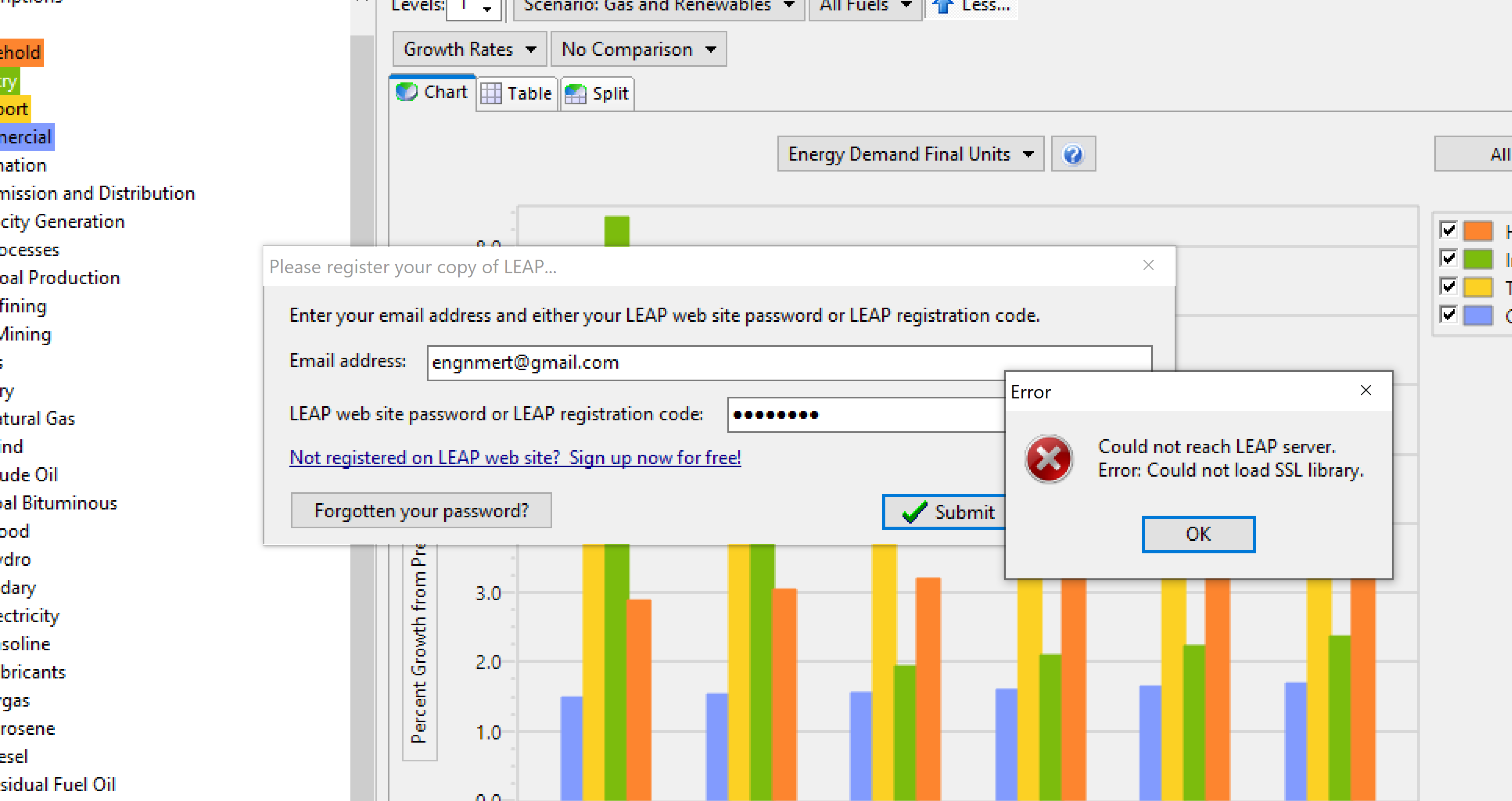

    When I first install the LEAP, I could only open pre-defined exercised like Freedonia and could not create a new area.
    Now I even can't open LEAP. When I tried to open I get "Elist-error. Duplicates are not allowed".
    Additionally I can't register online via LEAP. It show an error message "Could not load LEAP server. Error: could not load SSL library". I run the system as an administrator and give firewall privileges to LEAP.
    Please help me
    Engin

    Sorry Engin - I clearly broke something in the ".4" release. I am looking into that now. Will get back to you ASAP.

    I downloaded the latest version and I can create a new area.
    Thank you so much!

    Thanks for letting me know - much appreciated - this issue should now be fixed in 2020.1.6.
