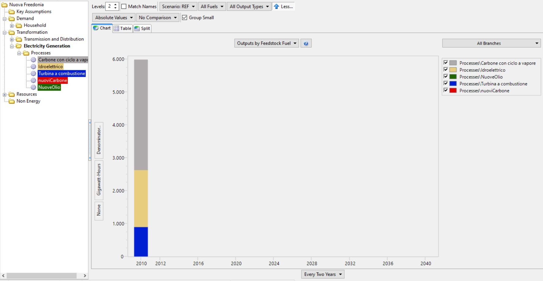

    I am new in LEAP and I am following the training exercises. In the section 1.4.3 LEAP shows me the graph in attached, with only the first year 2011 output values.
    The problem was taken into account in another post but I didn't solve.
    Could you help me to resolve, please? Thanks
    Roberto

    As like as two peas, I have the same problem as you. I have only the data in 2011, and I haven't got any answers. How did you solve the problem?

    There are a number of issues you need to check, but suggest by start by looking at the DispatchRule variable. If you are dispatching by process share from the FirstScenarioYear onwards, then have you specified non-zero data in the Process Share variable?
    Alternatively, perhaps you are trying to do merit order dispatch but you have not properly set the DispatchRule variable.
    Check in particular how you set variables both in Current Accounts and in scenarios.
