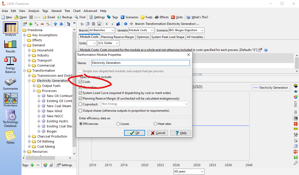

  • Charlie Heaps 8/17/2020
    Hi Lilibeth,
    Couple of things for you to check..
    1. Make sure you are looking at Transformation processes. Capital costs only exists there.
    2. If you don't see a variable (tab) marked capital costs, check the properties of the module and make sure that costs are enabled as shown in the attached.
