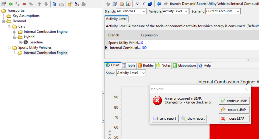

    Dear all,
    I am getting an error in adding the Transport Technology branch while doing Exercise 6.
    Please find clipped image below.
    Thank you.
  • Charlie Heaps 8/25/2020
    Thanks San - that is definitely a bug. I will try and get it fixed in next version. Meantime, sometimes you can work around that type of bug by exiting and then restarting LEAP.
    Apologies for the problems.
  • Charlie Heaps 9/2/2020
    Hi San,
    Thanks for your patience. This issue should now be fixed in 2020.1.17. Can you get it here: https://leap.sei.org/download
    and let me know if the fix works?
