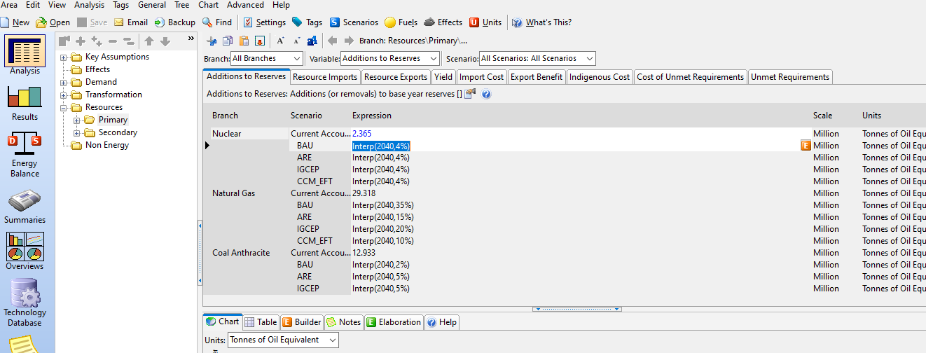

    Hello!
    I have developed scenarios on resources.i means i have changed the percentages of different resources in different resources.i have use the interp function to express the share in percentage of different resources (please look at the attached image) under "Addition of reserves".I have got the same results of all the scenario and i know i have put the wrong function under wrong branch.Now, i want to ask which function i need to use to the percentage of different resources,

    I'm afraid that won't work. You need to specify absolute values not percentage values. The values in your Interp function should reflect any additions to reserve in the specified years.
