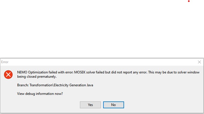

    I got error with this message (picture attached), on the OPdebug this is what came up:

    any help???
  • Charlie Heaps 2/7/2021
    The debug messages indicate that your PC ran out of memory.
  • Satria Kanugrahan 2/8/2021
    Thank you for your swift response Sir,
    What's the minimum memory that I should have to run this scenario?
  • Charlie Heaps 2/8/2021
    The memory required depends on the model size you created. I would recommend having at least 4 GB RAM. Suggest you look at the MOSEK documentation for more guidance.
