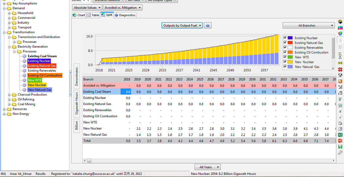

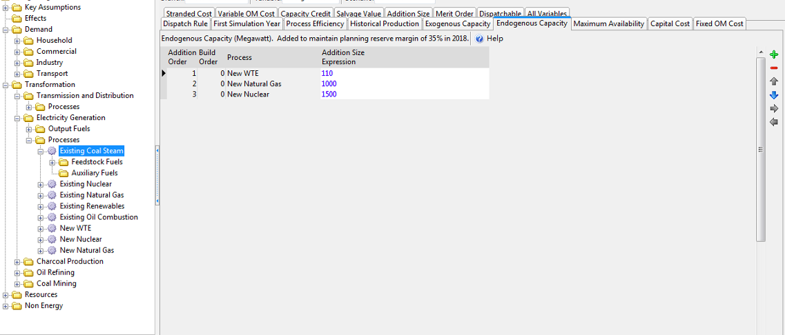

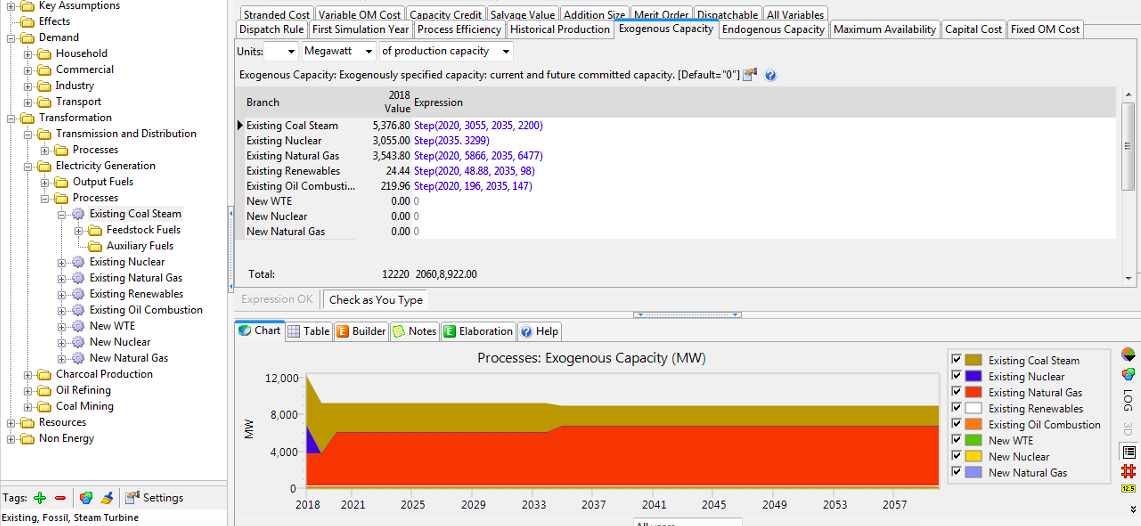

    Dear Colleagues, I have followed the steps on LEAP youtube tutorial to input exogenous capacity for existing electricity generatio and endogenous capacity for new generation. However, when I analyse the results, it cannot show the existing electricity generation output fuels at all. May I know how to fix this problem? Thank you very much!

    I believe there are still some values for the existing powerplants as well - that is why we can see "0.0" instead of just "-" for those plants.
    However, your outputs from new planta are excessively high (in billion GWh) than that for existing plants (thousand GWh) if you had followed tutorial. That is why with respect to total, the outputs of existing plants are so low that they got diminished. Please check your demand branch or the transformation parameters that can affect the electricity demand and/or generation.
