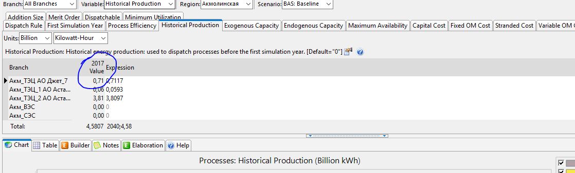

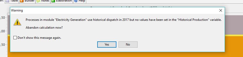

    Hi there,
    We are doing a desing of the new project. We set the demand and also set the electricity generation (basic info just to run the calculations). 2017 is our "first calcualted year" and we have put the values for Historical Production Variable (see picture 1). However, when running the result we get the warning (see picture 2), saying that no value have been set for 2017 Historical production.
    Did anyone have the same problem? Any help will be appreciated.

  • Charlie Heaps 4/19/2021
    Hi Inna - this looks like a bug although I thought I had fixed it already in a recent update., Can you tell me exactly which version of LEAP you are using (check bottom-left corner of main screen). Thanks and sorry for the inconvenience.

  • Inna Kim 4/19/2021
    Hi Charlie,
    Thank you for getting back. We have found the solution to the problem. We currently working with multiple regions project and we didnt set values in Historical Data for other regions. So that is why it gave us this error. We are facing another challege though. Would you be able to help us to limit transfer capability between regions? or will there be any training/workshops on that?
