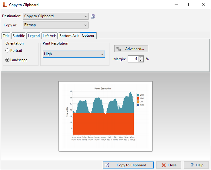

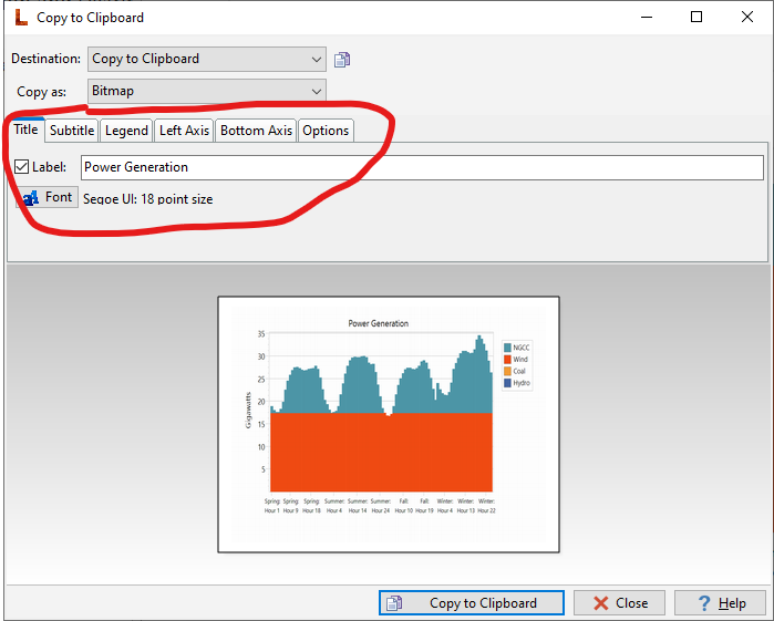

  • Charlie Heaps 4/28/2021
    When you copy, save or export a chart to PowerPoint, you will first be shown the chart export screen. From there you can adjust various common chart settings and those settings will be remembered between exports.
    Some of the more detailed chart setting may need to be tweaked each time you export though. I am planning on improving this feature so it remembers more settings in future. One tip: for better looking exported charts I suggest setting the print resolution to "High".
