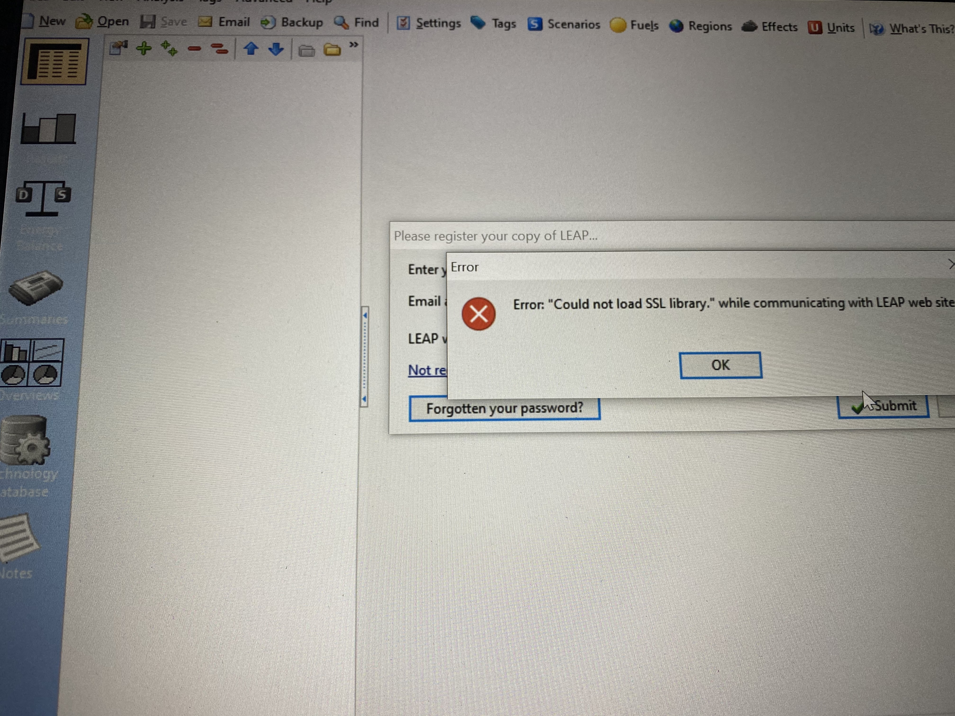

    Hi there,
    I get the attached error notification when setting up LEAP on my PC. Do you know what could be the cause?
    Thank you very much,
    best regards
    Jakob
  • Charlie Heaps 5/13/2021
    Hi Jakob - as noted in last email this seems to be related to issues with the LEAP's use of two .DLL files that provide communications over HTTPS.  I'm looking into this now and hope to have a better response for you soon.

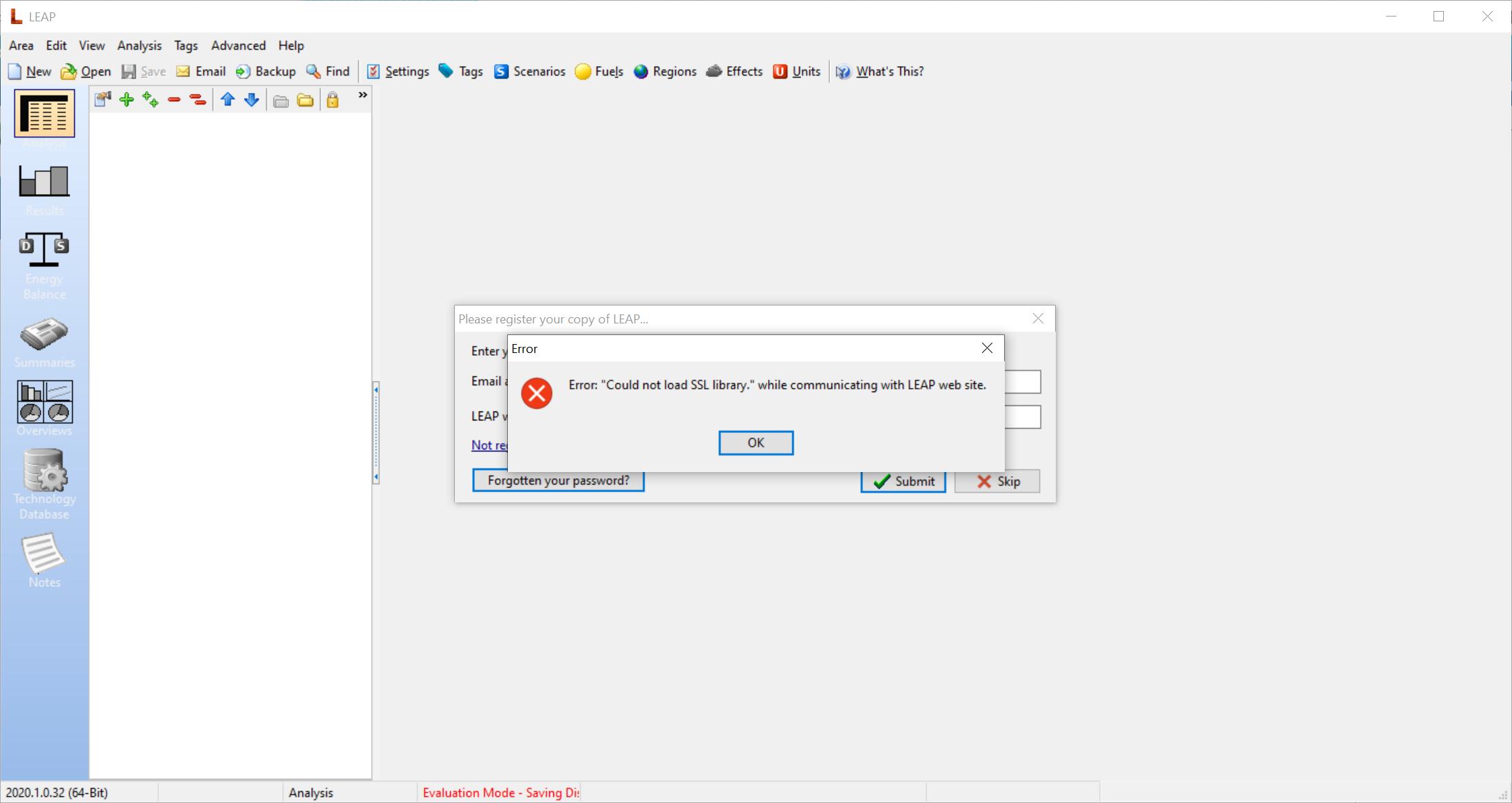

  • Lixiao Xu 5/21/2021
    Hi Charles, I have the same problem as Jakob's picture shown. What can I do to handle it? Look forward to your response. Thank you very much.

  • Charlie Heaps 5/22/2021
    Please update to 2020.1.33 which fixes this issue. Get it here: https://leap.sei.org/download
