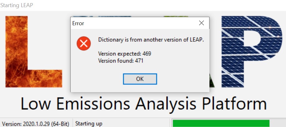

    Kindly see attached picture with a directory error I am getting. LEAP is refusing to open and giving me this error message. I updated LEAP yesterday (or day before) and was using with no issues until now. Could you kindly assist what I must do to solve this error?

    Hi Amanda,
    This usually indicates some problem during installation, possibly due to insufficient access rights. I would recommend fully uninstalling LEAP then reinstalling. You may want to delete the Documents\LEAP Areas folder and the Program Files\LEAP folders before reinstalling, although be sure to make backup copies of your own areas first.

    Thanks Charlie
    Yes, this was helpful.
