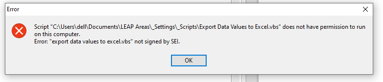

    Dear LEAP support
    The following error appears when I try to run any script even the scripts built in LEAP.
    Thank you for your time and effort.

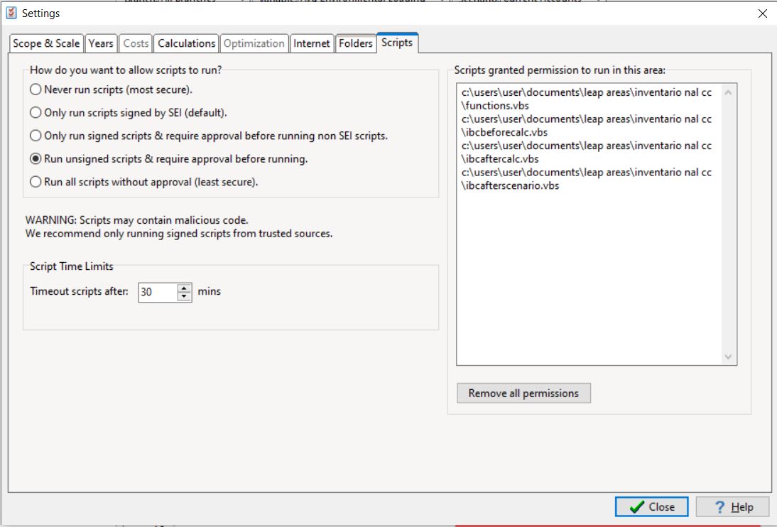

    Hi Ahmed,
    This happened to me before, you have to change the settings under your area, by default the scripts must be signed by SEI.
    Go to Settings // scripts // Run Unsigned scripts & require approval before running.
    For more information you can check this post: https://leap.sei.org/default.asp?action=thread&tid=5900&fid=22

    Thank you so much Andrés Robles.
