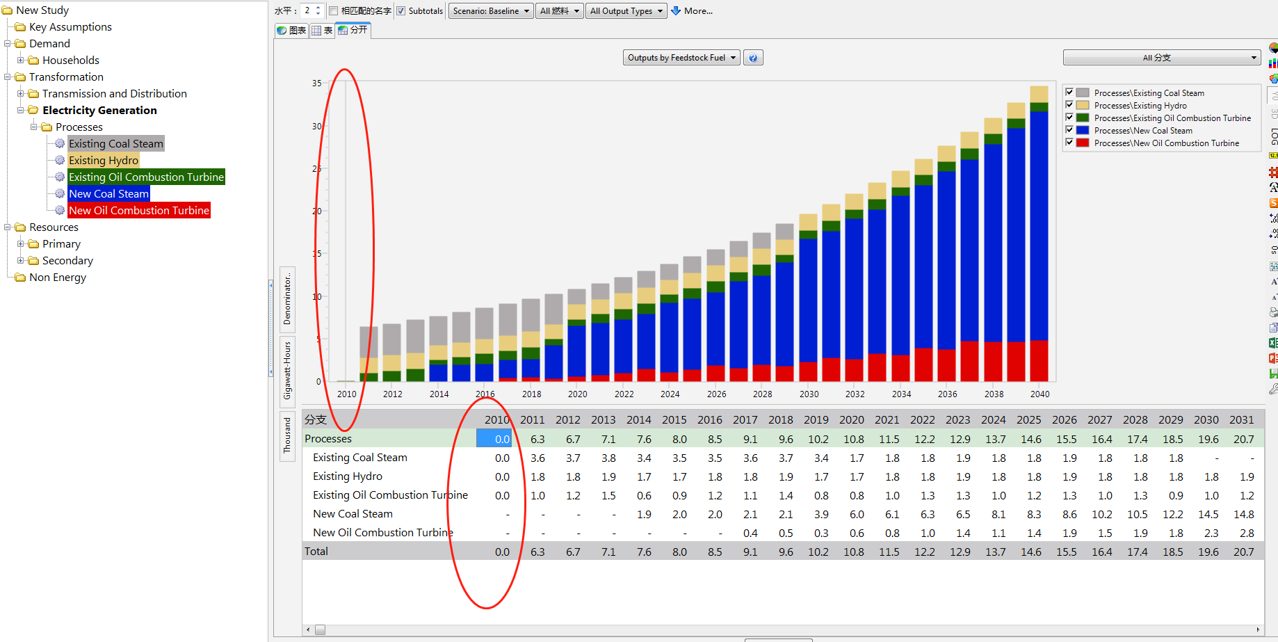

    Why is the data of 2010 0?
  • Liya Cai 7/4/2021
    Hi Xiaoxu,
    You'd better try to check the data of base year in Current Accounts.

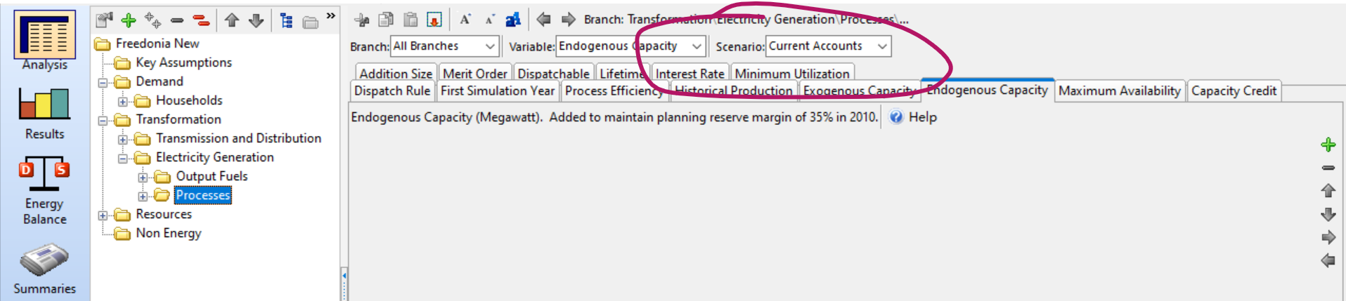

    I've encountered the same problem previously. And after comparing my model and the official model, I found out that Endogenous Capacity of electricity plants should be set ONLY to scenarios, and that one of Current Accounts should remain default with no settings.
