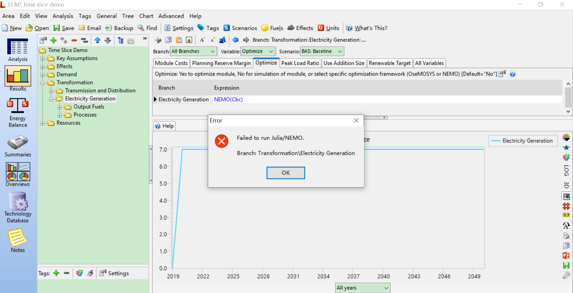

    When I run the result of the model of time slice demo, it shows me the following error. How to solve this problem. Any assistance would be appreciated.
  • Liya Cai 7/6/2021
    I have figured out this problem by reinstalling the up-to-date LEAP version and NEMO, meanwhile, settings of Windows update could be turned off.
  • Xiugui Wang 5/17/2022
    Hello, I also encountered the same problem, but I reinstalled the software and it didn't solve it. Is there any other way?
