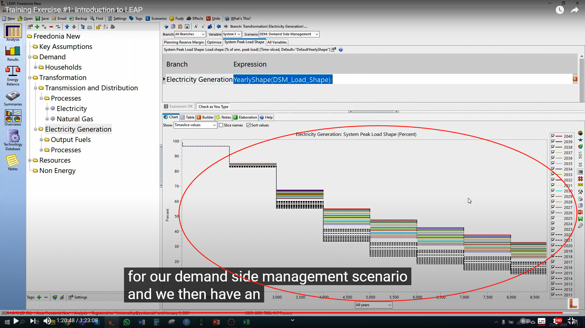

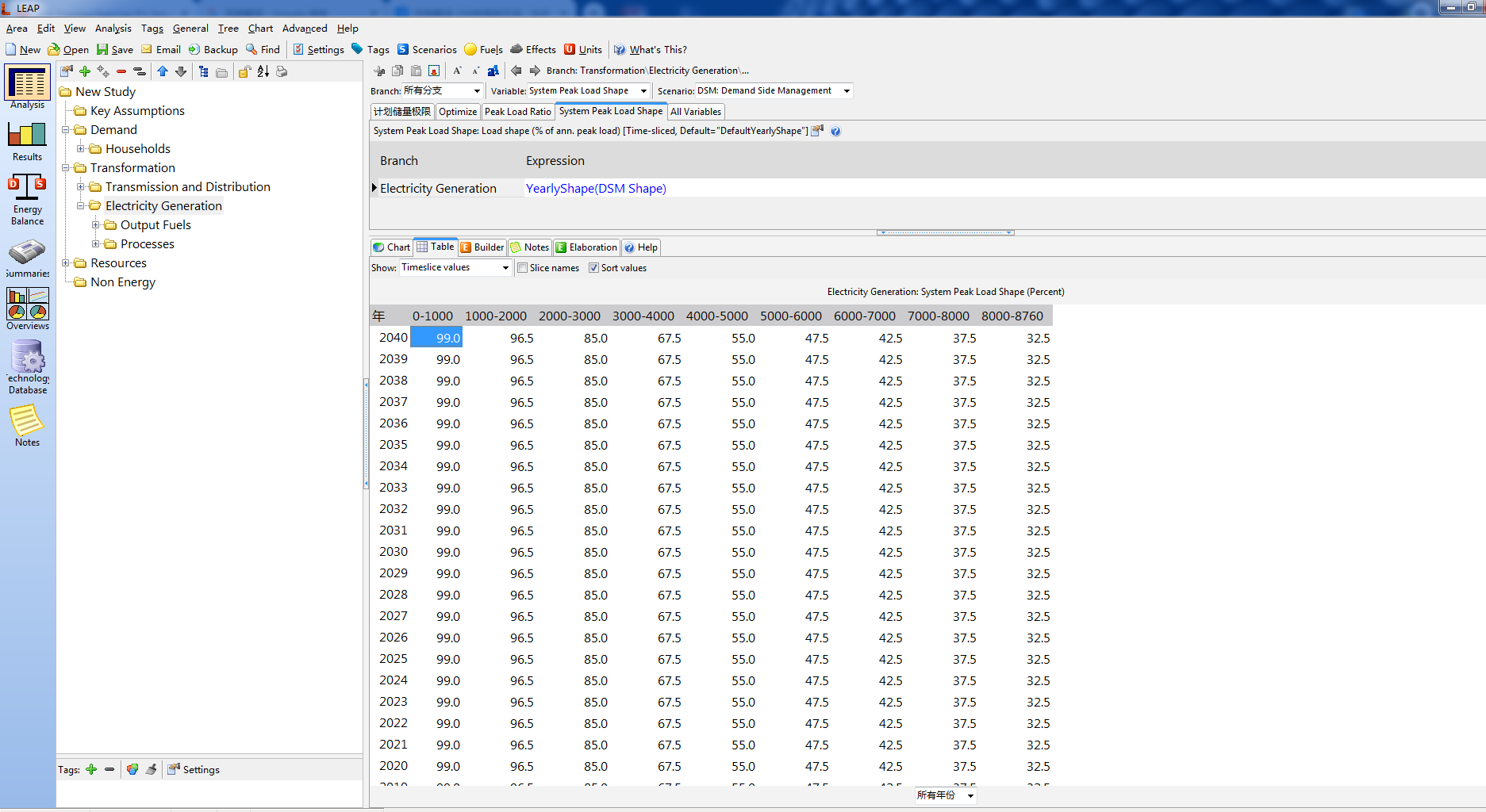

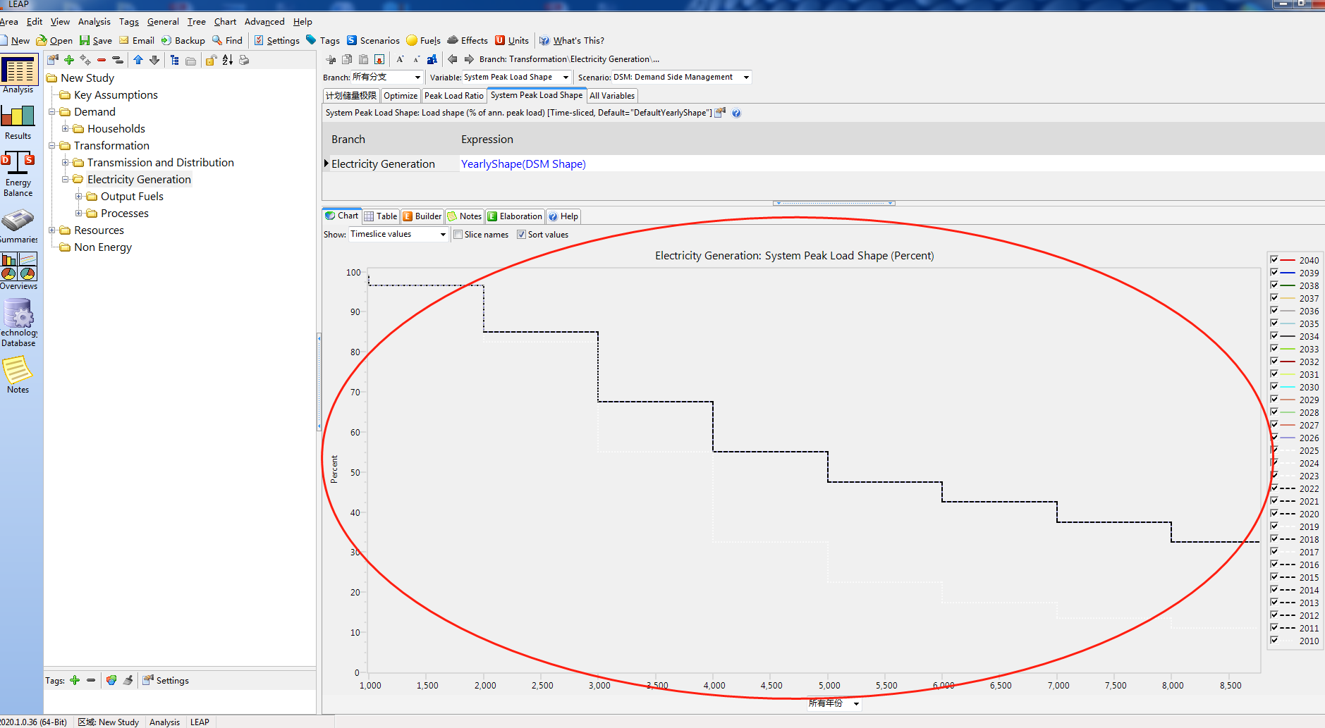

Why is the load curve inconsistent with the teaching video?The video shows the changes of data from 2010 to 2040。I think there should be changes every year. Which step did I do wrong?
Utsavshree Rajbhandari 7/6/2021
Dear Xiaoxu,
I think, the problem might be from Baseline scenario
Please check the yearly shape you have used in Current accounts and Baseline Scenario.
It should be the "SystemShape" and not the DSMShape"
