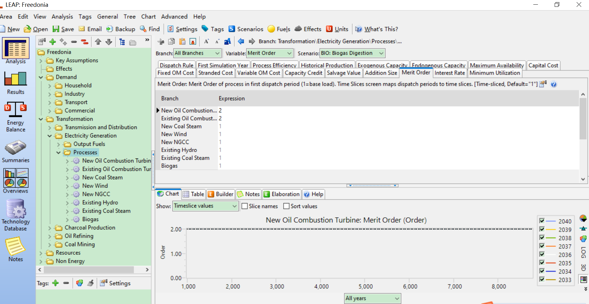

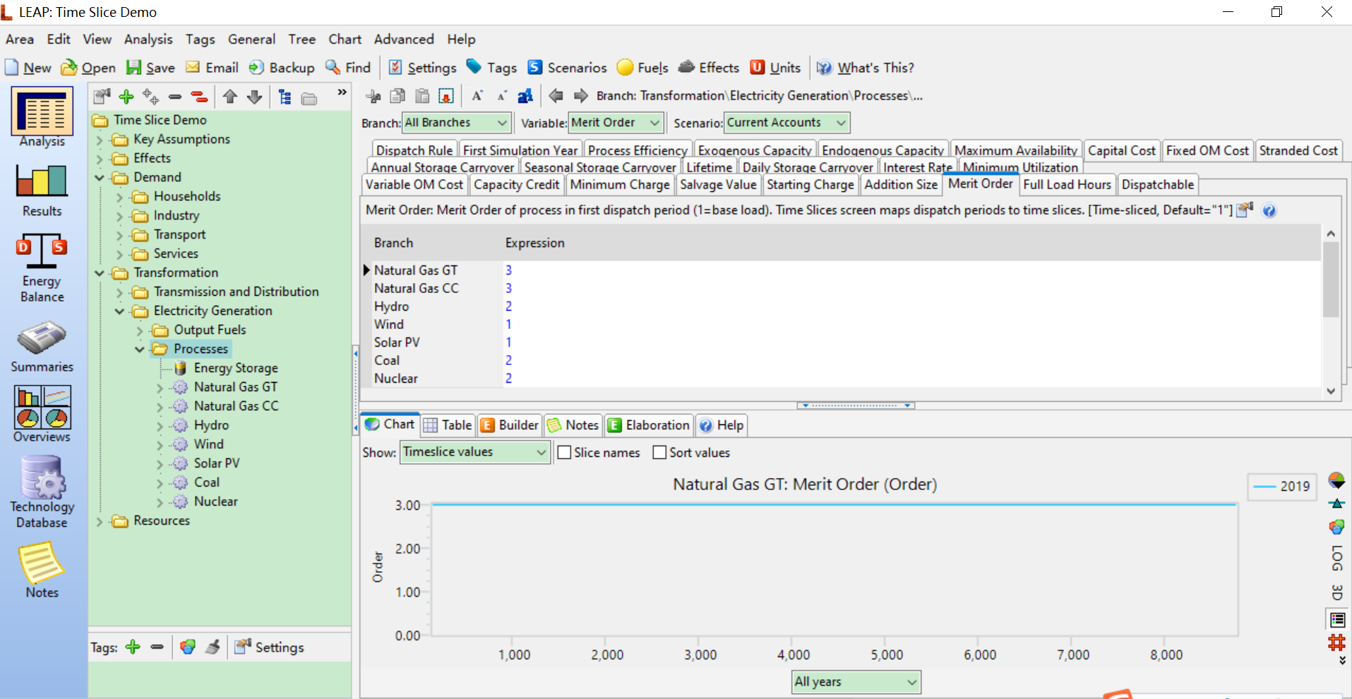

    Concerning the setting of merit order, I found that the value is different in various model demo. Generally, coal power is base load so the merit order should be set 1. Natural gas power is peak load so the merit order should be set 3, and so on.
    But the merit order of coal power and other powers in the model of Freedonia and Time Slice Demo are different. Does it be decided by the research objective? Could you please explain the criteria of Merit order setting. Thank you.

    Its up to you to set those values to match how the plants are dispatched in their local context.
