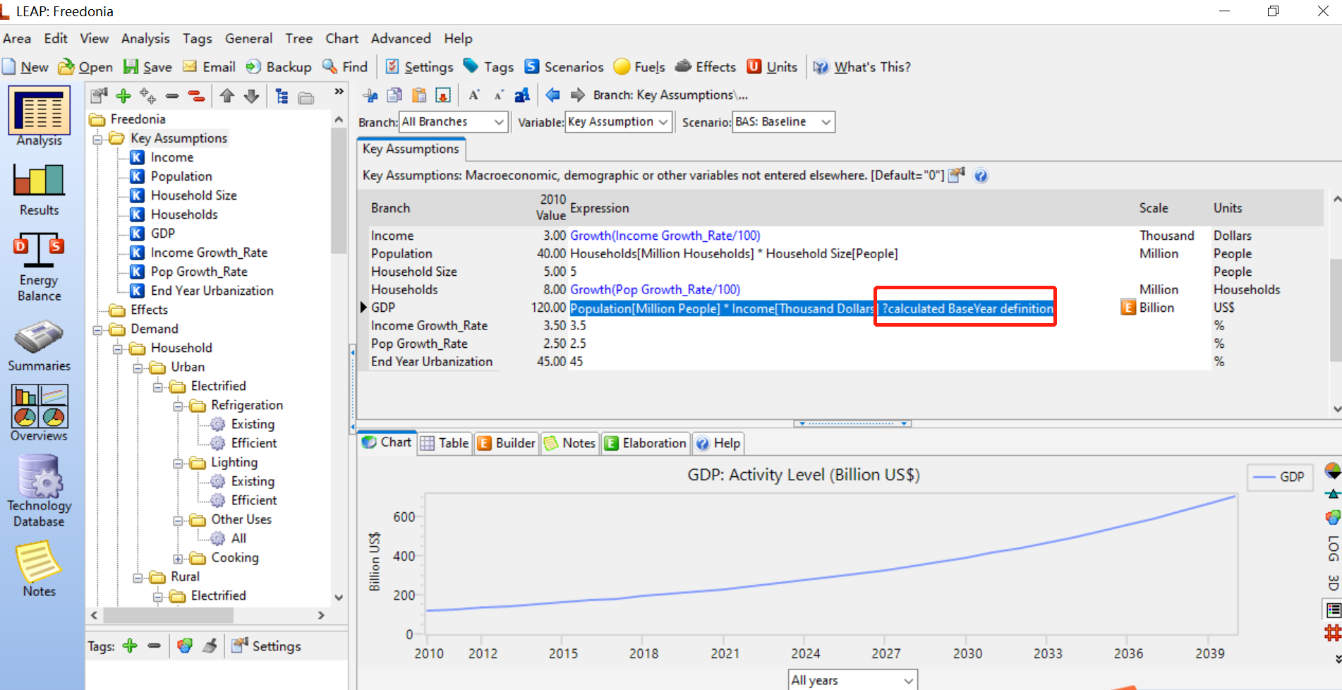

    I noticed that there is an equation in Key Assumptions branch of Freedonia area model. Could you please explain the back part of this equation? Please see as follows and attachment. Thank you.
    Population[Million People] * Income[Thousand Dollars] ?calculated BaseYear definition

    Anything after a question mark in an expression (?) is a comment. LEAP does not try to evaluate that text, but its a great way to document/explain an equation.
