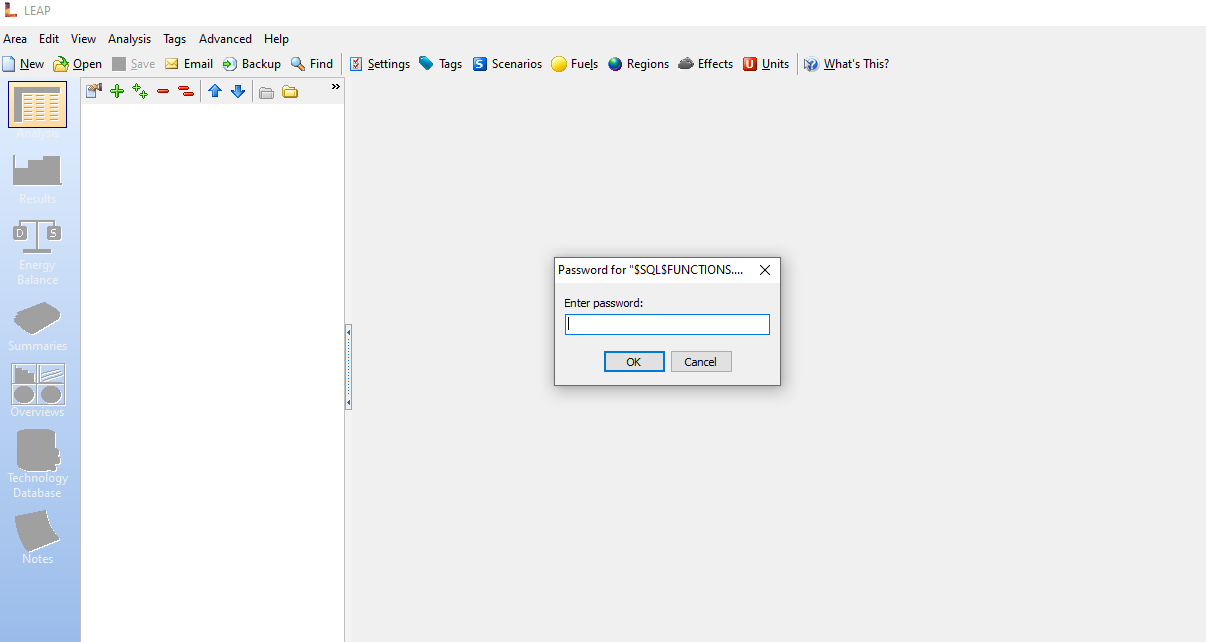

    Which password is supposed to enter here?
    As have tried all passwords of accounts and protected files but nothing works
    Regards
  • Charlie Heaps 10/11/2021
    This message can occur if you are trying to open a LEAP area that was created in a newer version of LEAP, but you are using an older version of LEAP (typically a version before 2020.1.27). I recommend that you update to the latest version of LEAP here then try again: https://leap.sei.org/download
