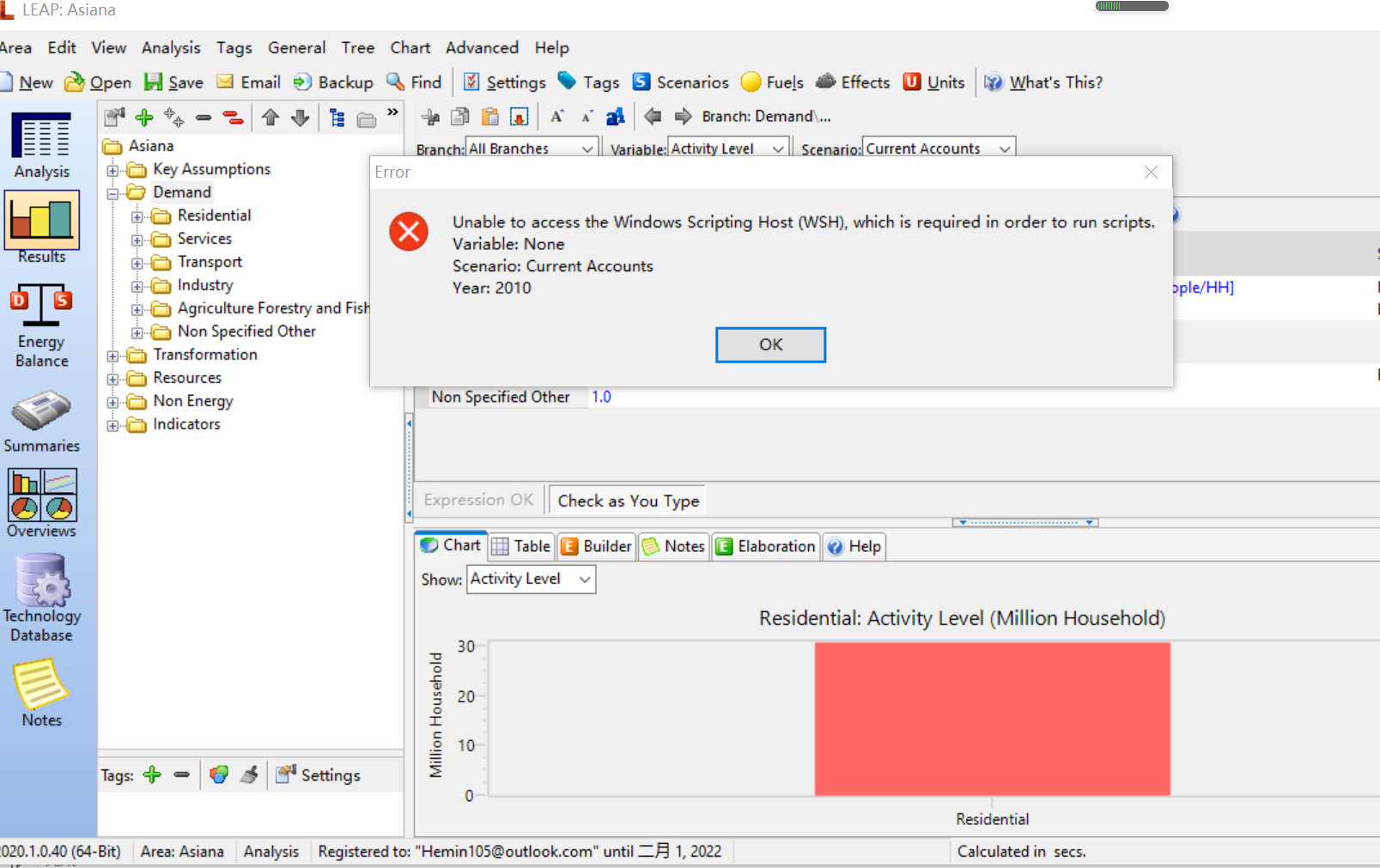

    Hi there,
    I get the attached error notification when running LEAP on my PC, Do you know what could be the cause?
    Thank you very much,
    best regards
    Min He
  • Charlie Heaps 10/11/2021
    This error normally indicates that some required components of LEAP are not properly registered with Windows. Try running the batch file registerleap.bat in the Program Files\LEAP folder. Make sure you have full administrative rights on your PC when doing this.
